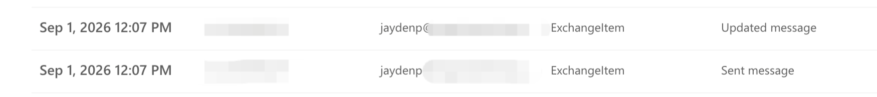

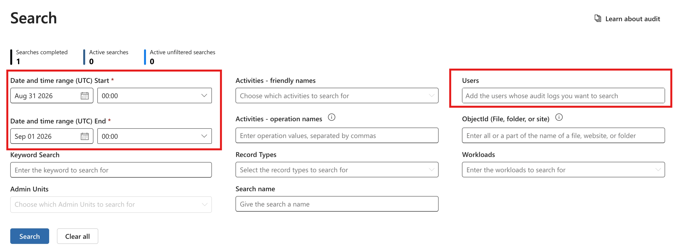

    Do the messages sent out appear in Sent Items of the Organizer mailbox?
    Does the organizer have any Power Automate flows, Outlook add-ins, inbox rules configured to their mailbox or calendar?
