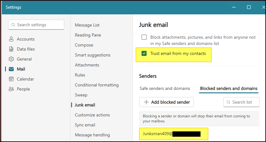

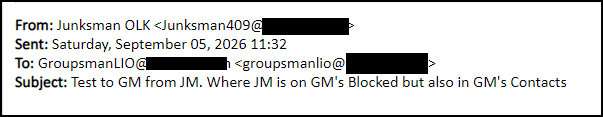

    @Aaron said
    [Accidentally added an address to Blocked. Could not remove. Tried to add to Safe. Could not add]
    If you only need to get an email off your Blocked list, or add to Safe, but can't save changes - Possible Workaround - Add to Contacts.
    I just tested this setup, and for me, if the address is in my Contacts (and Trust Contacts is Enabled), then the mail is delivered to my Inbox. Even if that address is also on my Blocked List.
    i.e. Trusted Contacts acts like a Safe List and over-rides anything on the Blocked List.
    Did you not see the same behavior? Or did you not have a chance to test?
    Some screen shots from my testing:
    Groupsman's Settings and Contact card for Junksman
    Mail sent from Junksman to Groupsman is received in Groupsman's Inbox.
    (If I remove Junksman's contact from Groupsman's People, then mail from Junksman is not delivered)
  3. Chloe-V 12,610 Reputation points Microsoft External Staff Moderator
