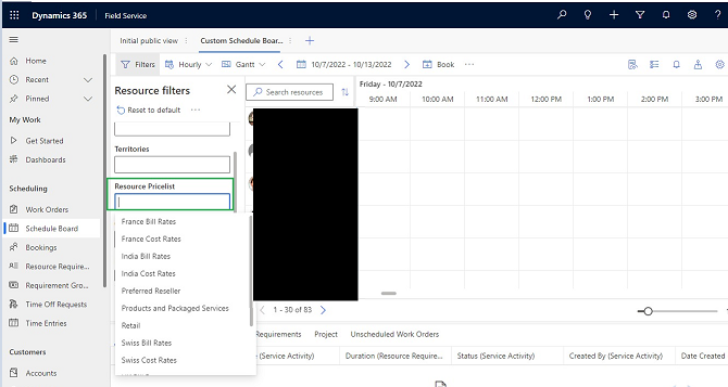

Hello! I have a problem with the time zone in Field Service Schedule Board, it doesn't keep the Time Zone I select, every time it changes to another one and I have incorrect timing on bookings. I mention that every resource has the same time zone. Also I've notice that there are other options that change in board view, like travel duration. Do you know how I can fix this problem?
