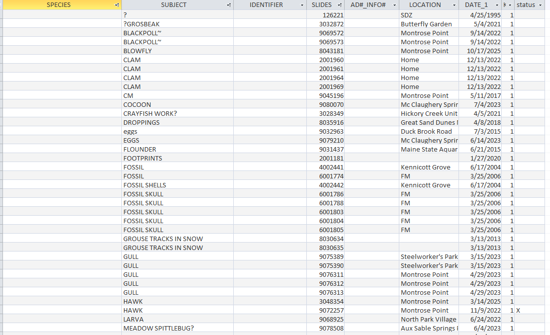

For years I have just used Access 2007 on my laptop, though I have Office 365. As the disc wouldn't work on my Win11 PC, and the laptop has a problem, I finally decided to use the later access, and opened a 2007 database. I updated a number of records in a table and then I went to a query and found that now,it says the recordset is not updateable. I has always been so on the laptop for decades.
When I first opened the 365 Access, it said something about needing to be the administrator, but it seemed to make no difference till I went to change records in the query. I am the sole user of this personal computer and thus the administrator, so if that is why and it doesn't know that, what do I do.

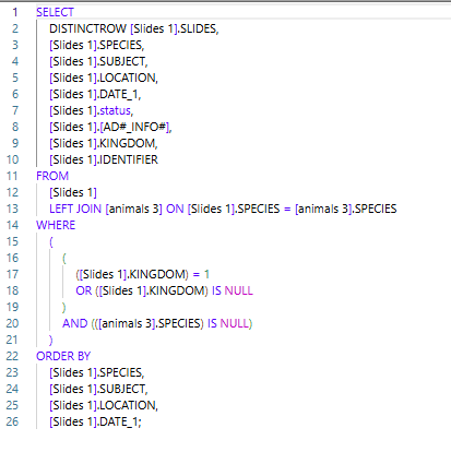

    So this query was set up to see which animals did not have IDs in the database. I use a 1 in the kingdom field to indicate an animal. I use a 2 to indicate plants. the query was set up with criteria in that as 1 or empty, meaning that if it had a blank field, it would find those records also.
    I decided to look for plants without species names and changed the kingdom filed to 2, and much to my surprise, I was able to update records. So I went back to look for animals instead and changed the field to just 1, and it became updateable, working like it should. So though it worked for years with the earlier Access, 365 did not like.

    I wouldn't assume this is an Access 365 issue. The rules that determine whether a query is updateable really haven't changed much over the years.
    Since you mentioned you can still edit the table directly, but not through the query, that tells me the database itself probably isn't read-only. I'd be looking at the query definition or the environment instead.
    A few things I'd check:
    • Is the database in a Trusted Location?
    • Did the ACCDB come from another computer and get blocked by Windows?
    • Does every table involved have a primary key?
    • Did the query accidentally get changed to use DISTINCT, GROUP BY, UNION, aggregate functions, or another feature that makes it non-updateable?
    I'd also make a copy of the database and run Compact and Repair. Moving an older ACCDB to a newer version of Access can sometimes expose minor corruption that older versions tolerated.
    Finally, if you can post the SQL for the query, someone here can probably spot the cause pretty quickly. It's very unusual for a query that has been updateable for years to suddenly stop being updateable just because you installed a newer version of Access.
