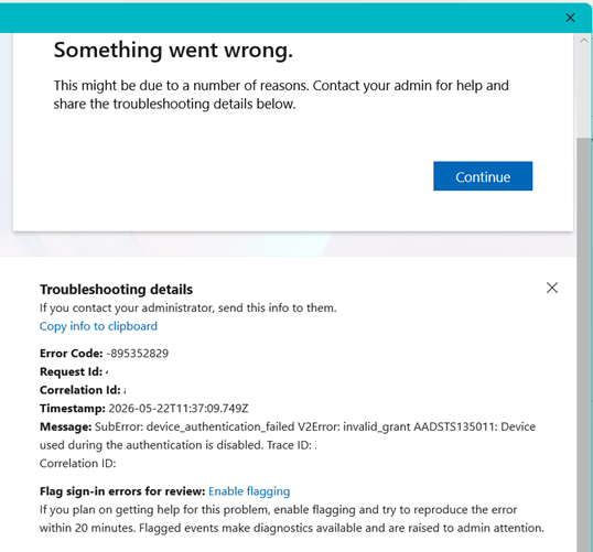

i cannot sign in to account which has microsoft office license i keep getting this error

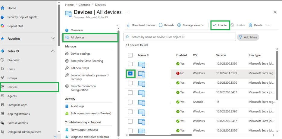

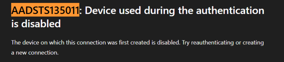

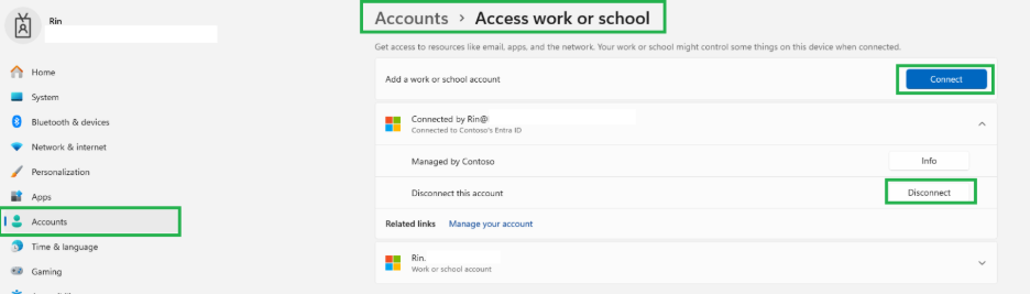

    Based on the screenshot you mentioned, the error you’re encountering (AADSTS135011) usually means that the device being used during the sign‑in process is registered in Microsoft Entra ID, but it has been disabled. Even if your Office license is assigned correctly to your account, sign‑in will still fail because the device itself is blocked from authenticating.   User's image
    If you are an end user, the best next step is to contact your Microsoft 365/IT administrator, since they have the required permissions to check and fix this.
    You can ask them to review the device status in Microsoft Entra ID by signing in and going to Devices, then searching for your device or your username. If the device appears in the list and is disabled, they can simply select it and choose Enable to restore access.
    In case the device is no longer listed there because it was deleted, it will need to be registered again on your machine. You can do this by going to Settings, then Accounts, then Access work or school. From there, select your account and choose Disconnect, then reconnect it by signing in again. This will re-register the device and restore the authentication relationship.

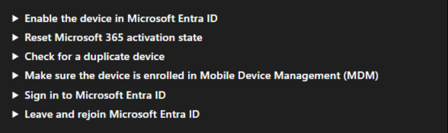

    If after trying these steps the issue still persists, it would be a good idea for you and your admin to follow the full step-by-step guidance from: Microsoft 365 Apps activation error Your organization has disabled this device - Microsoft 365 Apps… That guide covers additional checks to make sure everything is properly configured.
    If the issue continues after trying these steps, or if you get stuck at any point along the way, I’d recommend asking your admin to submit a support ticket with Microsoft. Once the case is created, a technical support engineer can work with you directly, take a closer look at the backend, and help resolve any sync or configuration issues t hat might not be visible from your side.
