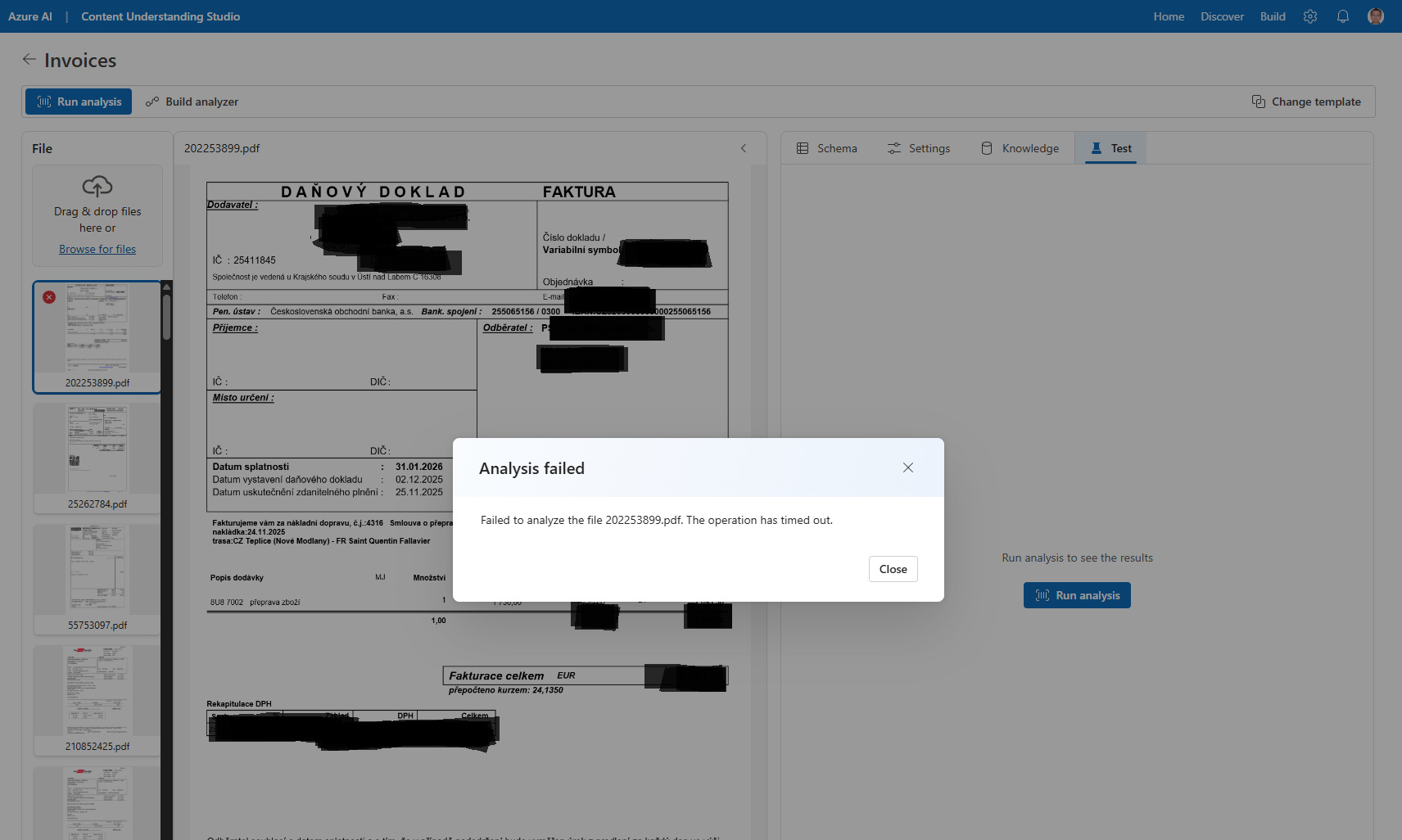

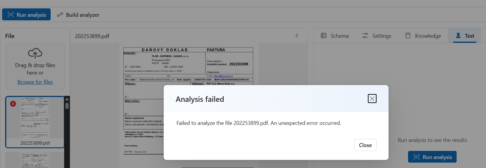

We are experiencing an issue with Azure AI Document Intelligence. When using the prebuilt Invoice model, analysis fails for every PDF invoice we test in the Azure portal Test tab. Error shown: "Analysis failed. Failed to analyze the file. An unexpected error occurred."
Details:
  • Service: Azure AI Document Intelligence
  • Model: Prebuilt Invoice
  • Happens for all invoice PDF files, not just one document
  • Occurs directly in Azure portal during testing image

     Thank you for sharing the detailed information and screenshot regarding the issue observed with the prebuilt Invoice model in Azure AI Document Intelligence.
    Based on the behavior described, the document upload and preview in the portal Test tab appear to be functioning as expected. However, the failure occurs during the document analysis stage with the message:
    “Analysis failed. Failed to analyze the file. An unexpected error occurred.”
    This indicates that the issue is likely occurring during backend processing rather than during file ingestion. Considering that the same behavior is reproducible across multiple PDF invoices, the scenario may be influenced by a combination of service conditions, model behavior or input characteristics.
