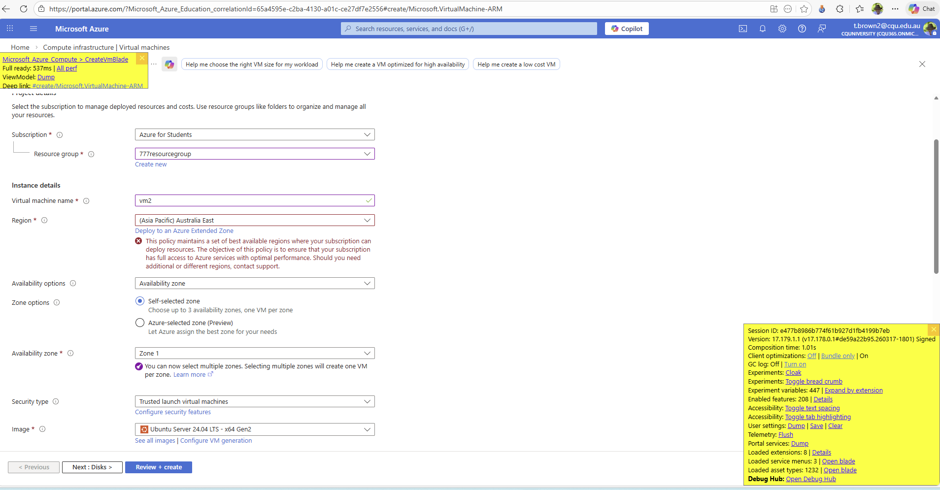

Hi, how can I get help from Azure support. I have an issue where there are no regions available to create VM's as seen below. But I am unable to contact anyone to assist with the issue
This policy maintains a set of best available regions where your subscription can deploy resources. The objective of this policy is to ensure that your subscription has full access to Azure services with optimal performance. Should you need additional or different regions, contact support.

    When checked Azure for Students doesn’t include a paid support plan, but you still get free subscription-management and billing support—so you should be able to open a “Regions” support request at no cost. Also, seeing “no regions available” usually means there’s an Azure Policy (Allowed Locations) blocking all regions for your subscription.
    Here’s what you can try now:
    Check for an “Allowed locations” policy – In the Azure portal, search for “Policy” > Assignments. – Look for any policy that restricts locations at your management group or subscription level. – If you find one, remove or update it to include at least one region so you can deploy VMs.
    Open a subscription-management support request – Sign in to the Azure portal, go to Help + support > New support request. – Under Issue type, pick Subscription management → Regions. – Fill in the details and submit. You don’t need a paid plan for this type of request.
    (Optional) If the Help + support blade is missing, you can file a request via the web: https://azure.microsoft.com/en-us/support/create-ticket/
    Do you see the Help + support blade at all, or is it completely missing?
    Hope this helps & let us know if any further questions?
