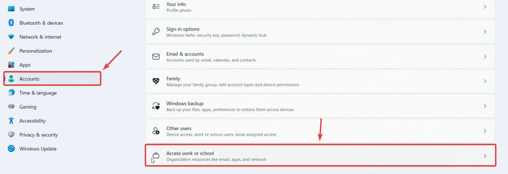

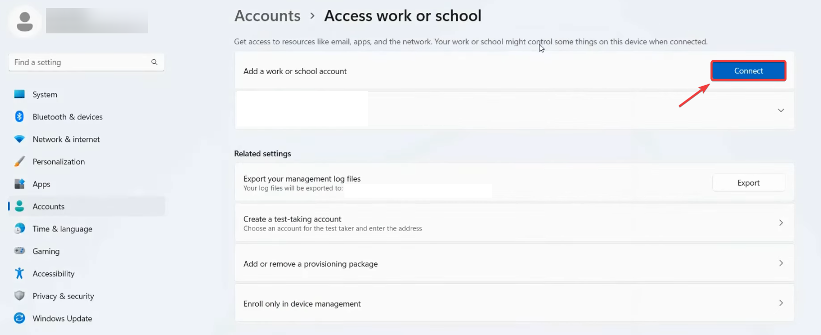

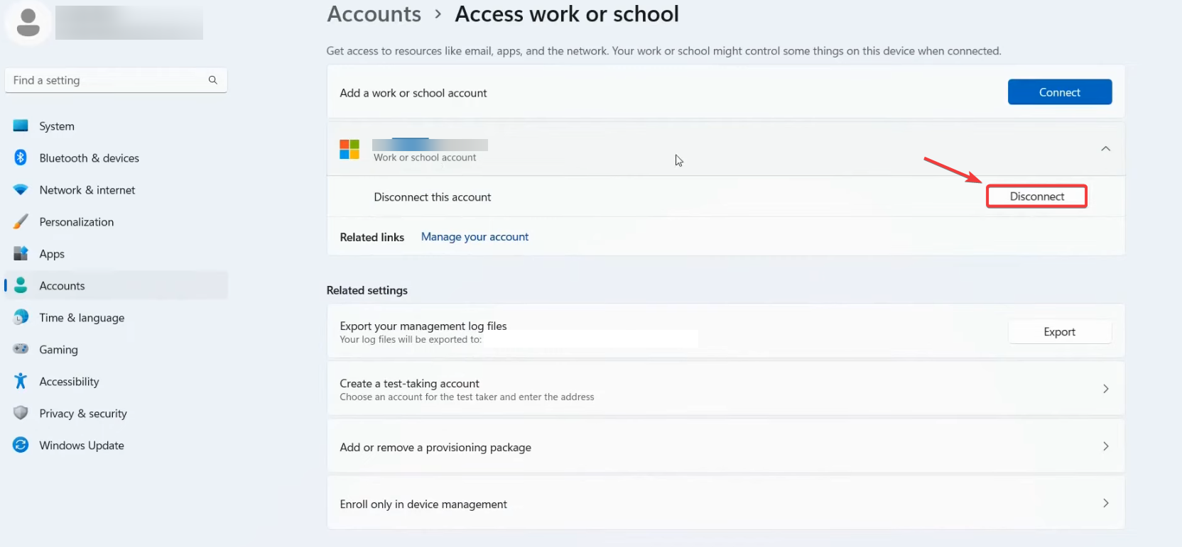

    1. Open Windows Settings and go to Accounts.
    2. Select Access work or school.
    3. Locate your business email address. If it is listed, click it and select Disconnect.
    4. Restart Outlook. It should prompt you to sign in as if it were a fresh setup. During the sign-in, ensure you check the box that says "Allow my organization to manage my device" if prompted.
