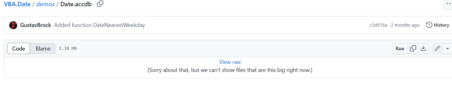

    You cannot "view" an Access database; it is not a document.
    You must download it using the small button at the right and run it with Access.

    Hi GutavBrock
    I cannot your demo database.
    Please see message below
