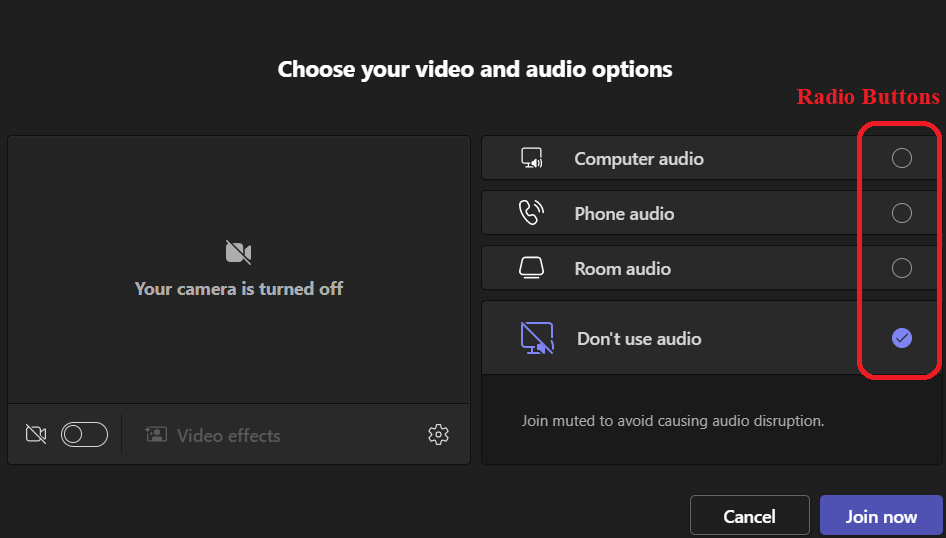

    It was the first time I selected the "Don't use audio option" for joining a call:
    After this, every time I tried to join a meeting I was not prompted for the device selection anymore, I was just added to the meeting in mute:

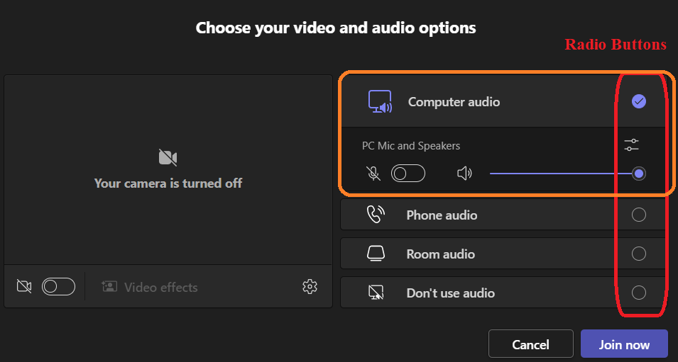

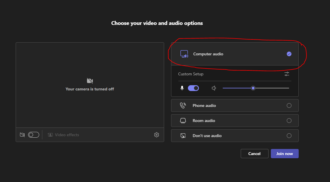

    I tried to look everywhere for a setting what would allow me to restore the device selection, with no luck. Finally, I went into the "Calendar" section and used the "Meet now" > "Start meeting" button:
    From here I was able to see my current selection and change it, so it started to pop back up every meeting afterwards.

    I start via "Meet Now" a meeting with myself only and changed the the settings from "Don't use audio" to "Computer audio" when joining. From then on all new meetings had my speaker on again.
    You have to start the meeting before the change gets permanent.
