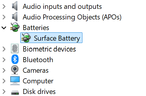

Have run diagnostics etc and not change. started two days ago, cant unistall updates, as system will not allow me. I cant find the charging drivers in the device manager, or a battery driver update, all is shown as up to date

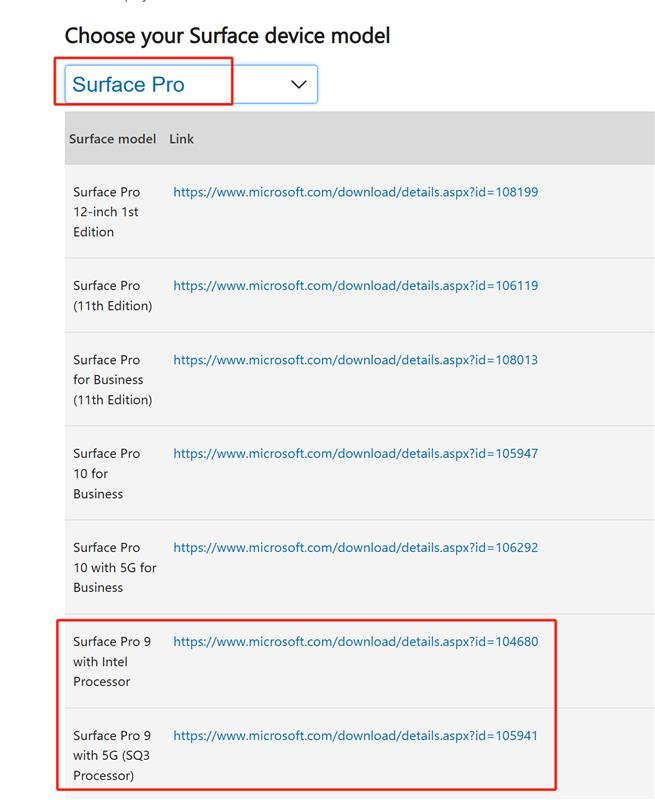

    However, if you notice that your Surface Pro 9 still cannot be charged normally even when the PD charger meets the conditions, please try manually downloading and installing the driver and firmware package compatible with Surface Pro 9:
    Download drivers and firmware for Surface - Microsoft Support
    Be sure to distinguish clearly the CPU model used by your Surface Pro 9.
