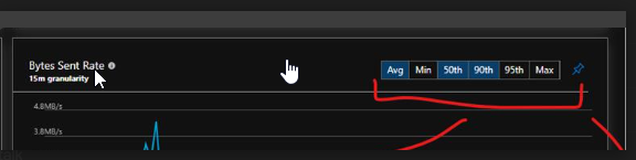

For my question today, I would like to know if it is possible to add a clickable bar in an Azure Workbook through our Azure log analytics workspaces that allows to view the
Avg
Min
Max
50th Percentile
95th Percentile
and so on, I think this would really help us a lot because we are always manually creating workbooks where we summarize and aggregate the avg|min|max etc and a clickable bar at the top similar to what we see in Insight Analytics would be fantastic

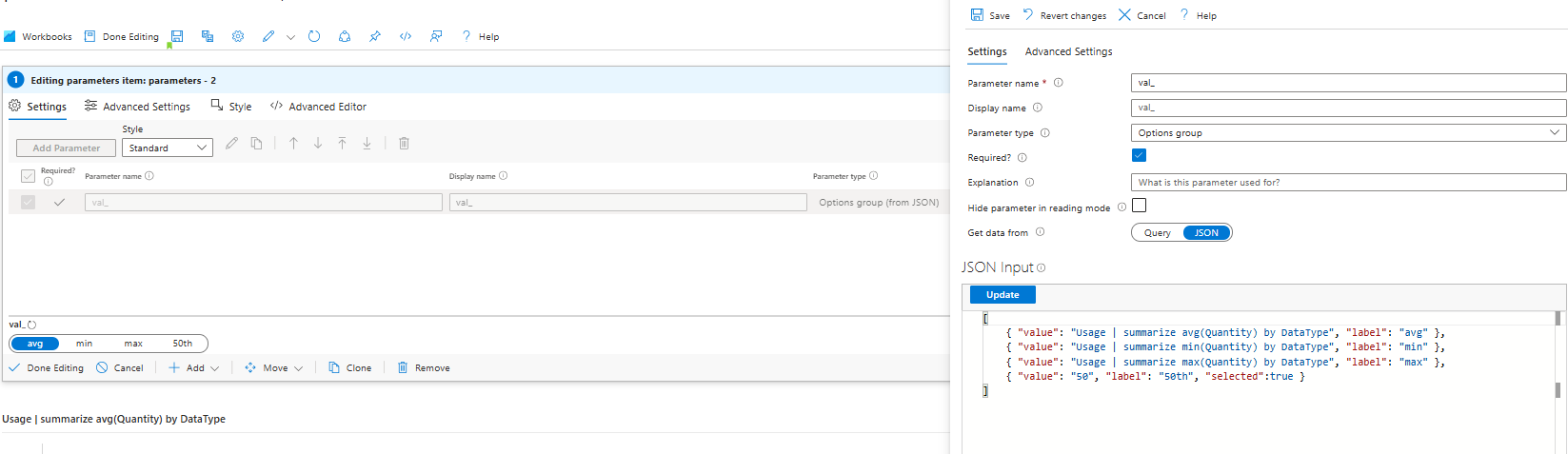

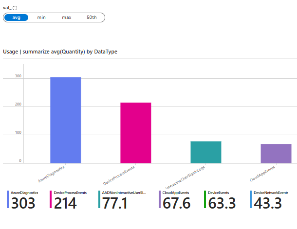

    Step 1, set up a parameter and add the queries to match the display values, using an 'Options group':
    Step 2:

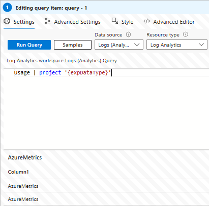

    Use the output in the chart query

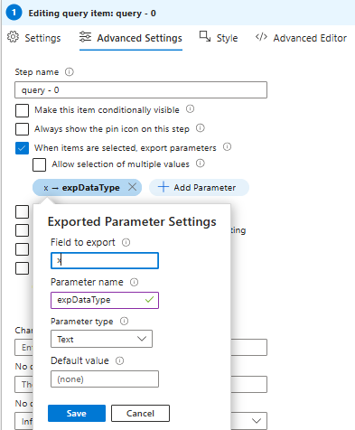

    Hi, to enable a selectable chart (I'm using bar chart as an example), you need to allow the fields to be exported, such as the X axis shown here when they are clicked on.
    Also I'm not sure I recognise the workbook you are naming, where is that from?
    You can then use that exported parameter elsewhere in your workbook, a top tip here is to set it up so that the new data is only shown (conditionally visible) if a Item on the chart has been selected. Like this:
    Then you can use that exported value, in other parts of the workbook (this is just a demo use):
