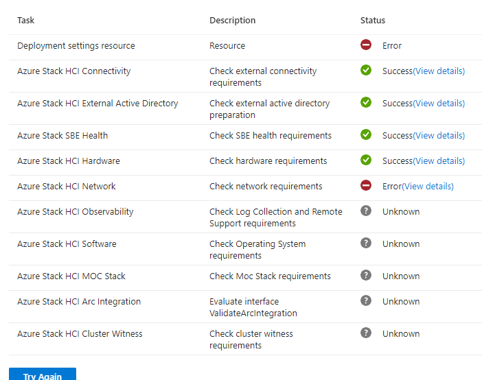

Hi Team,
We are trying to setup Azure stack HCI 23H2 and facing issues. Azure stack HCI 23H2 cluster deployment validation failed at Azure Stack HCI Network. Here is error -
"Could not complete the operation. 200: No Updates were received from the HCI device in the last 30 minutes, so marking CloudDeploy_Validate Operation cancelled. Please contact Microsoft support for further details."
I checked both nodes. A converged switch is created on the first node, but there is no switch on the second node.

    Thanks for the update. That's true, Inbox drivers are not supported for use with Azure Stack HCI. To identify if your adapter is using an inbox driver, run the following cmdlet. An adapter is using an inbox driver if the DriverProvider property is Microsoft.
    Reference: https://learn.microsoft.com/en-us/azure-stack/hci/concepts/host-network-requirements#driver-requirements
