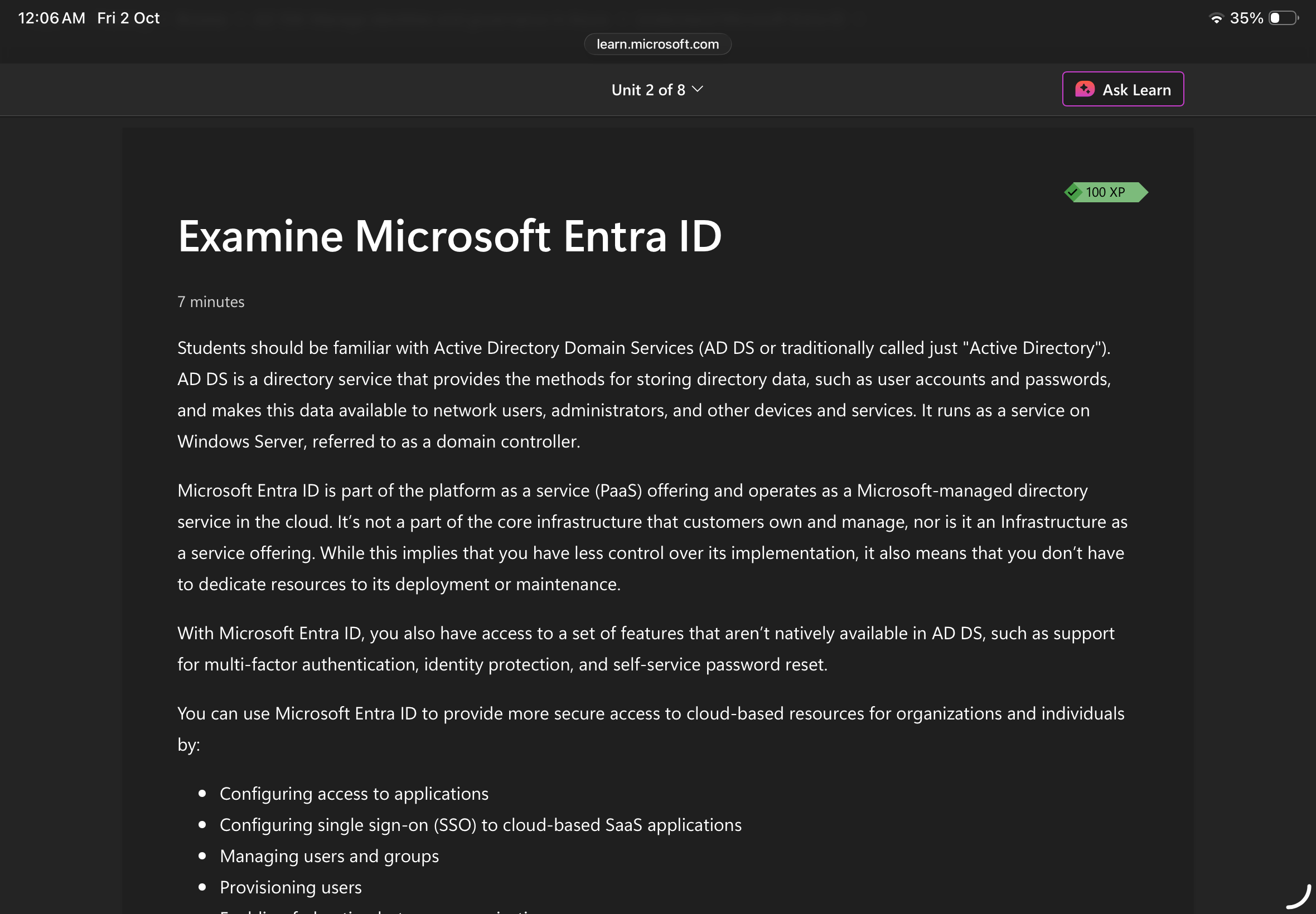

Azure AD is a Software-as-a-Service (SaaS). IaaS would imply that you can host your own services on Microsoft/Azure's AAD infrastructure (which you can't). Another point is you have 0 patching to do. In a IaaS environment, you are responsible for patching and upgrading software. Microsoft takes care of this for you and you don't have to know any thing going on behind the scenes.
