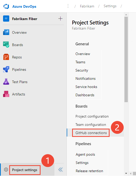

  1. Open the web portal for your Azure DevOps Server.
  2. Select the Azure DevOps logo to open Projects, and then choose the Azure Boards project you want to configure to connect to your GitHub Enterprise repositories.
  3. Select Project settings > GitHub connections.
    Screenshot of open Project Settings, GitHub connections.
