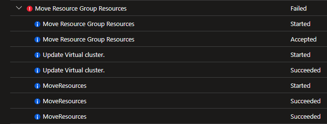

I am attempting to move an Azure SQL virtual cluster (microsoft.sql/virtualclusters) to another resource group within the same subscription. The pre-move validation succeeds however the move ultimately fails. This is supporting a Managed Instance. Is there something I need to do to SQL MI before the move? If not, what is the best way to get this resource into the desired RG? The statusCode is "conflict" but am not sure what that means.
        "statusCode": "Conflict",
        "statusMessage": "{\"error\":{\"code\":\"ResourceMoveFailed\",\"message\":\"
Azure SQL Database

    Unfortunately, this is not supported, Internal product team is working on the set of improvements for the virtual cluster and this is part of the scope, however, the expected timeframe is Q3 this CY.
    A virtual cluster always ends up in the same resource group as the virtual network used for instance deployment, depending on the organization of the resources on your side, you would have either to re-create the resources or eventually move the instances to another subnet which is in another resource group.

    Thanks for your reply. I wonder what the purpose of the 5-minute pre-move validation is, if not to determine if the resource is supported for the move.
    As for the ultimate purpose, Resource Groups are best used as boundaries for resources that share the same lifecycle. We deployed a SQL MI to support a datawarehouse effort, however it sits on an already established VNET, which is used for other services as well. For delegation of management, cost reporting and overall resource management, I wanted to put the SQL virtual cluster in the same RG as the Managed Instance (and other datawarehouse components).
    But either way, I appreciate the clear answer.
