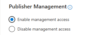

This configuration works as expected when the Azure Managed Application is published as an Azure Marketplace offer and the Managed Application plan is configured with "Publisher Management" > "Enable management access", see https://learn.microsoft.com/en-us/partner-center/marketplace-offers/azure-app-managed#publisher-management-access
In this scenario, the managed application is deployed into the customer's tenant, the ACR credentials are successfully retrieved from the publisher's Key Vault, stored as secrets in the Azure Container App, and the container image is pulled from the ACR without issues.
However, when "Publisher Management" is changed to "Disable management access", deployment of the managed application in the customer's tenant fails with the following error:
