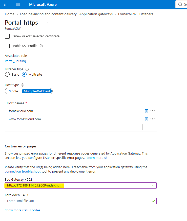

I want to configure the custom error pages for my listener in application gateway. The static .html page is in another VM which is different virtual network with application gateway.
When running the "connection troubleshoot" tool, I noticed the "Outbound NSG diagnostic" status is Denny. How to resolve it?
Please refer to the information below:
My application gateway firewall is using "Standard V2".
My application gate way's Virtual network/subnet : fornaxNet / fornaxNetSub
I have created Peerings to connect to the VM (in another Virtual network)
The VM is in Virtual network/subnet : SPD-SIT-Network/SPD-SIT-Subnet1
Have also created the Peering.

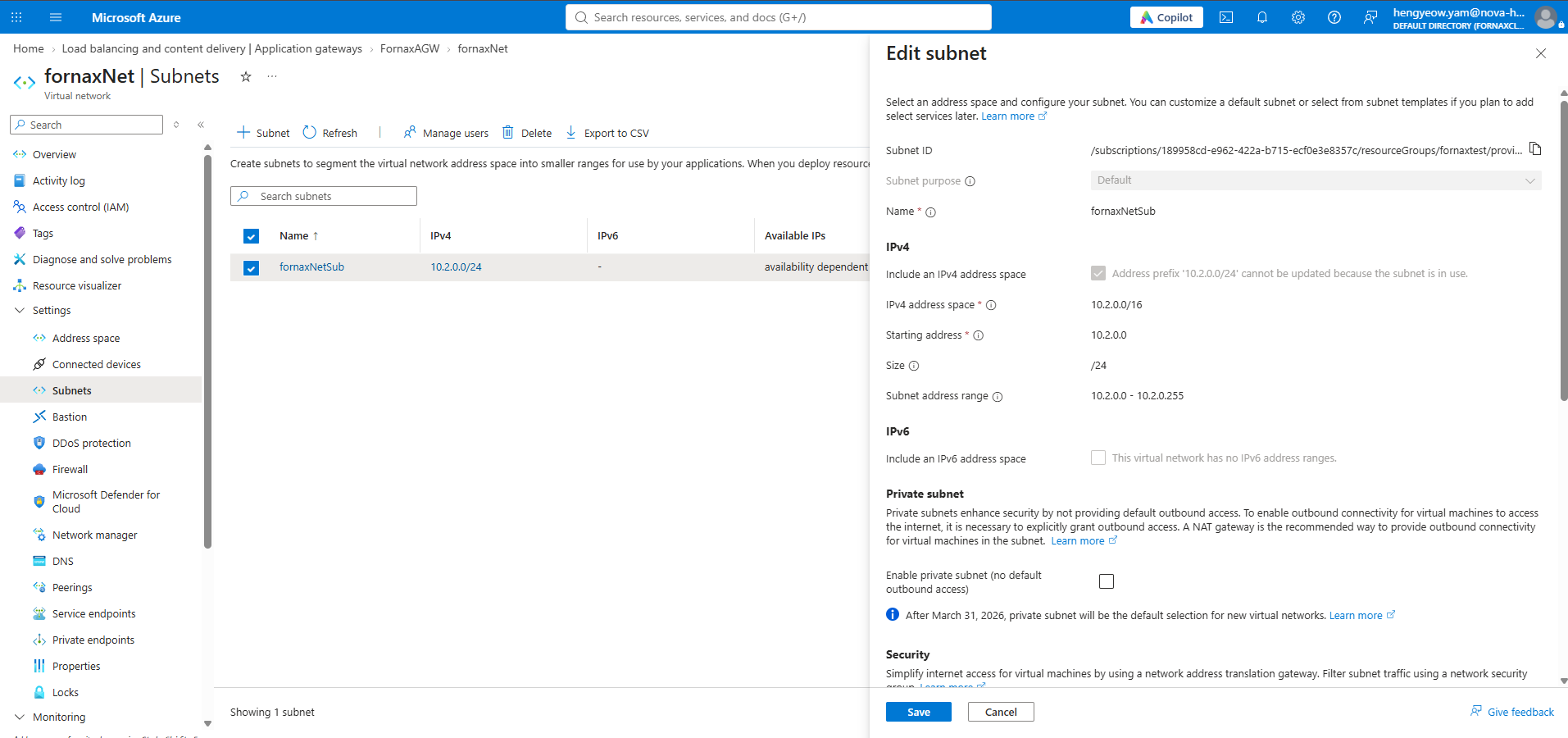

heng yeow (nova) • 90 Reputation points
2026-10-15T04:20:12.0533333+00:00 In the Azure portal, navigate to Network security groups > [Application Gateway subnet NSG] > Outbound security rules.
Hi Allan Solomon Mejia, thanks for the reply, but I couldn't locate my Application Gateway subnet NSG. Please assist how to proceed.Could you confirm:-

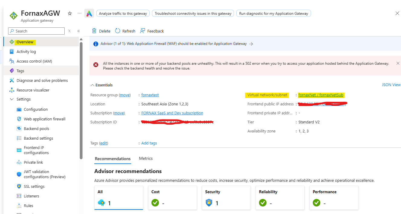

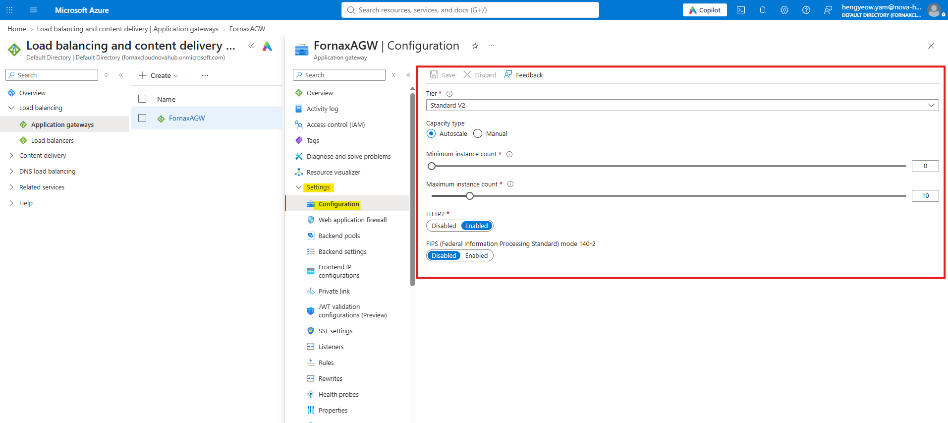

2026-10-19T12:14:14.2533333+00:00 For Application Gateway subnet NSG, Under Settings > Configuration, there is no virtual network and subnet displayed here.
But I found my Virtual network/subnet in the "Overview" page, the subnet is fornaxNetSub
But it seems not associated with Network security group (or you can advise me how to locate it)

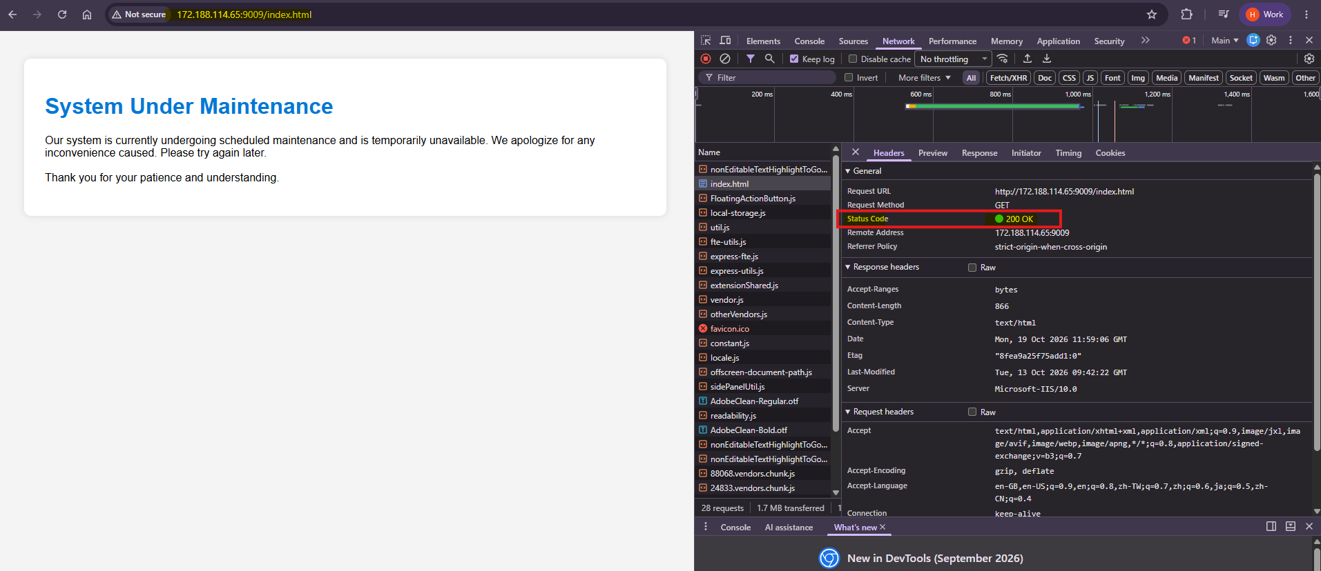

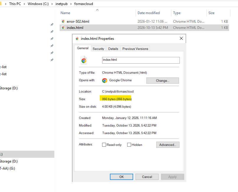

This is my public accessible static page URL : http://172.188.114.65:9009/index.html
The URL returns HTTP 200 when accessed.
The index.html file size is only 1KB and without any css/js file
I have confirued it in my application gateway listener
But when I access my site, https://fornaxcloud.com/, it still doesn't show the static page. Can you help check why?

Looking back at your original question, I understand that your main concern is the "Outbound NSG diagnostic: Deny" result from Application Gateway's Connection Troubleshoot tool, particularly when accessing the maintenance page hosted on VM-2.
Based on your screenshots, the Application Gateway subnet fornaxNetSub doesn't appear to have an associated Network Security Group (NSG).
This is important because we shouldn't assume that the diagnostic result is caused by an outbound rule on that subnet.
1. Verify the NSG association
Navigate to: Virtual networks > Your VNet > Subnets > fornaxNetSub
Check the Network security group field.
If it displays None, no NSG is directly associated with that subnet.
In that case, there is no subnet NSG outbound rule to modify.

You've confirmed that your maintenance page URL returns HTTP 200 and that the HTML file is approximately 1 KB.
These results satisfy two important custom error-page requirements.
However, the URL being reachable from your browser doesn't independently prove that Application Gateway can retrieve it.
