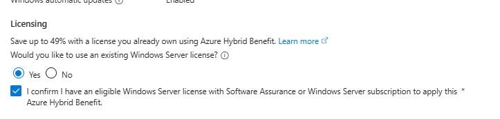

I create an Azure VM with AHB enabled and after created i can see message that the AHB was deativated.
Is the AHB not supported for 2025?

    Azure Hybrid Benefit (AHB) for Windows Server is supported for Windows Server 2025. Microsoft documents that all Windows Server OS-based images are supported. The "AHB deactivated" message right after creation is therefore not caused by the 2025 version itself. I can't see your screenshots in the page text, so the cause is most likely one of these:

    For new deployments, set the license type explicitly. In the portal, tick the licensing checkbox on the Basics tab. In the CLI or templates, use:
