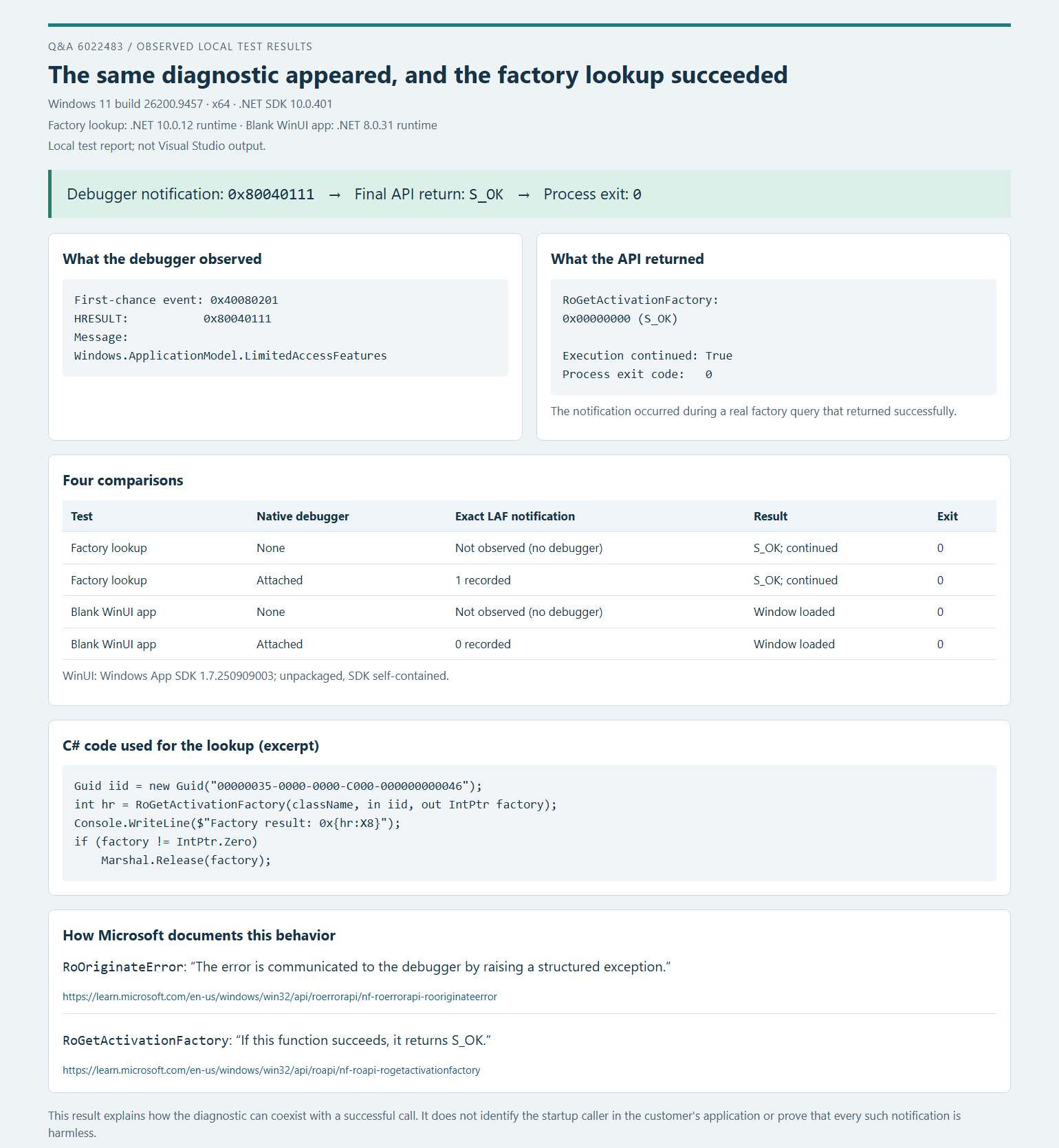

I reproduced the notification with a C# factory lookup on Windows 11 build 26200.9457, x64, using the .NET 10.0.12 runtime (SDK 10.0.401). With a native debugger attached, requesting the factory for Windows.ApplicationModel.LimitedAccessFeatures produced 0x80040111, but the call returned 0x00000000 (S_OK) and the process exited with code 0. Microsoft documents S_OK as a successful RoGetActivationFactory call.
A blank WinUI app using Windows App SDK 1.7.250909003 and the .NET 8.0.31 runtime, unpackaged, also ran successfully with and without a native debugger. Its debugger run did not produce the LAF notification. The factory test reproduces the message, but it does not identify the startup caller in your app.
This screenshot combines the recorded results, a code excerpt, and the relevant Microsoft documentation; it is a local test report, not Visual Studio output.
Factory lookup results, four comparisons, C# code, and Microsoft documentation
The console output was:
Factory result: 0x00000000
Execution continued after the lookup.
