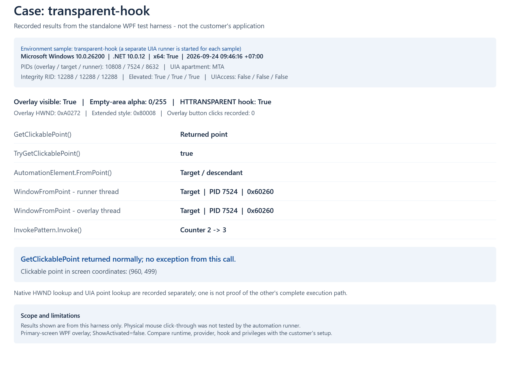

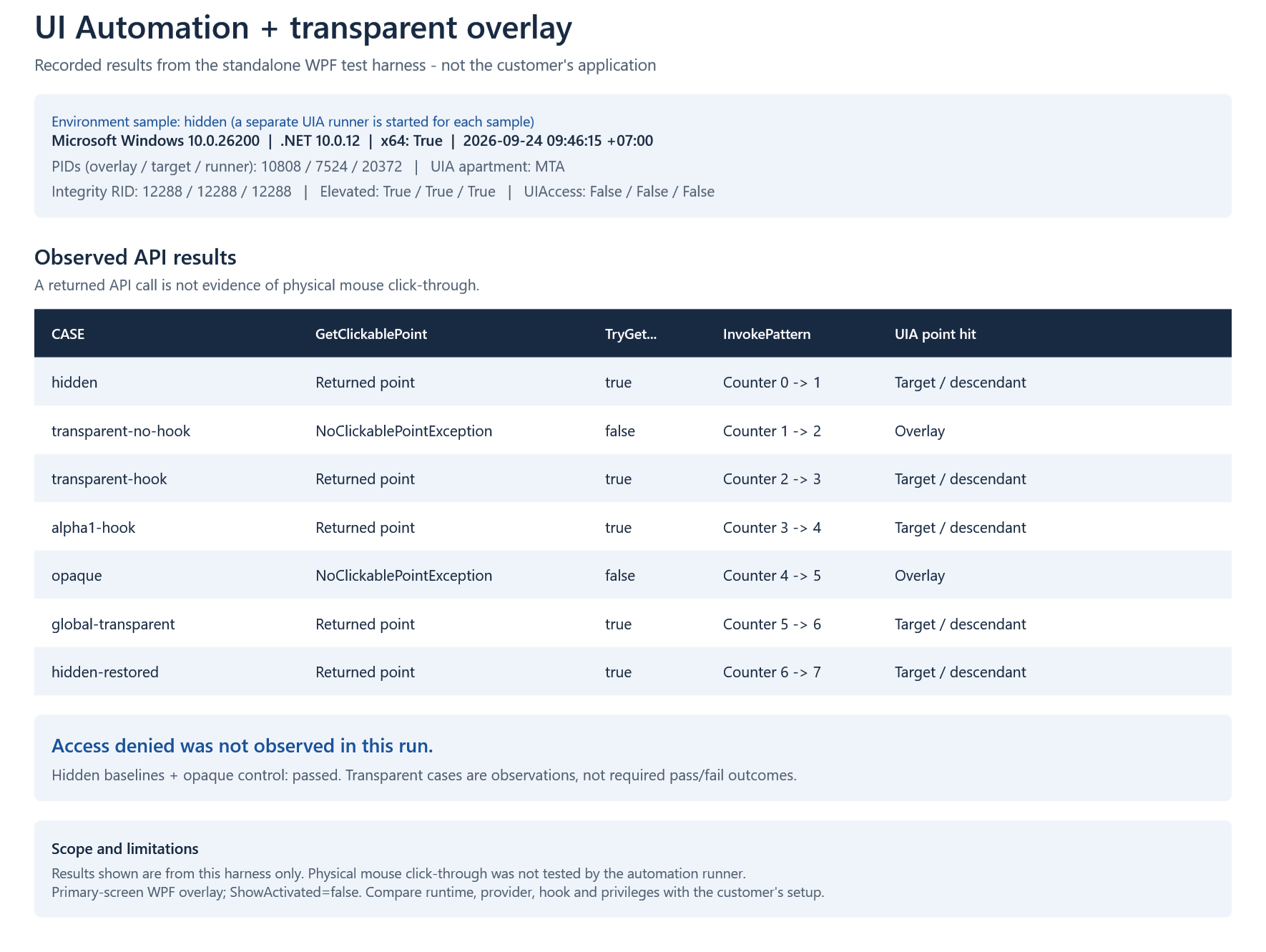

I tested a standalone WPF reproduction, but did not reproduce Access is denied. With the overlay hidden, and with it transparent while the HTTRANSPARENT hook was enabled, GetClickablePoint returned a point. With the hook disabled, and with an opaque overlay, it threw NoClickablePointException. InvokePattern.Invoke() activated the target button in every configuration tested.
The screenshots below show the complete comparison and the transparent-overlay case with the hook enabled:
Overview
transparent-hook
One observation may be relevant: the runner (PID 8632) and the overlay (PID 10808) ran in separate processes, yet the runner's native WindowFromPoint returned the target HWND rather than the overlay. The harness records the native HWND lookup and the UIA point lookup separately, so this does not establish the execution path GetClickablePoint takes internally.
The test ran on Windows build 26200 and .NET 10.0.12, with an MTA UIA runner. All three processes were elevated at the same high integrity level, with uiAccess=false. It therefore did not test a lower-integrity runner accessing a higher-integrity target or overlay. Not reproducing access denied under matched privileges does not rule out a security-boundary issue in your environment; the UI Automation Security Overview provides the relevant background. The harness also uses ShowActivated=false, covers only the primary screen, and does not verify physical mouse click-through.
