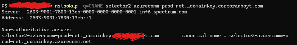

An nslookup proves that it should be wired correctly.

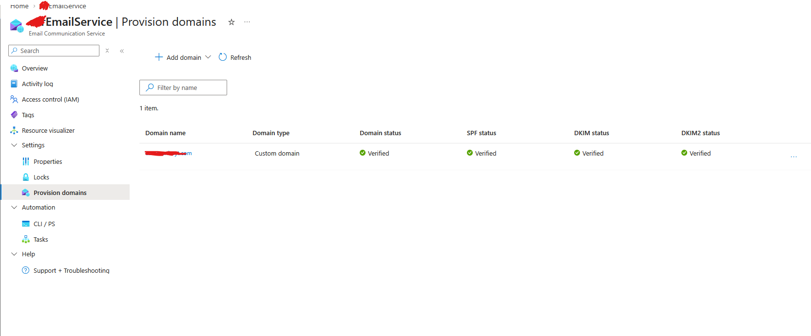

In the resource itself via Azure Portal:
Screenshot 2026-09-21 102817

Hi Cameron,
Please follow instructions below to remove and re-Add your custom domain to your Email Communication Service (ECS). In most cases this will fix the issue you are seeing.
1. Edit the TTL for you SPF TXT record and set it to low value (e.g. 300 or 600 seconds).
2. Delete the verification TXT record (ms-domain-verification). Leave the DKIM/DKIM2 CNAME records as they are now.
3. Wait 1 hour for TTL to expire
4. In Azure portal, navigate to your Email Communication Service -- Settings -- Provision domains, click on context menu (three dots) to the right of your custom domain, select Remove, confirm. Wait for the notification message letting you know that the domain has been removed.
5. Add your custom domain to your ECS under Provision domains. Create new verification DNS TXT record, only this time give it low TTL like 300 or 600 seconds. This will help speed up troubleshooting.
6. Periodically click Refresh button to see if verification is finished. Usually you will see the Domain status switch to Verified within about 10-15 minutes and then almost instantly SPF/DKIM/DKIM2 will also switch to Verified. Sometimes you may need to click Configure for SPF or DKIM or DKIM2 and go through the wizard on right, but then when you close that and refresh they will switch to Verified.
7. Once everything is working properly, go back and edit TTLs to be what they were before. For example, 3600 (1 hour) for your SPF TXT record. I only wanted you to use low TTLs during troubleshooting.
Please reply back with your results, whether positive or negative.
Thanks.
-TP

  1. Cameron Oberg 20 Reputation points
    2026-09-21T21:53:49.23+00:00
    I just needed to add a communications resource and link my email resource to it to expose the keys. Domain related workaround suggestion fixed the DKIM2 problem.
  2. Cameron Oberg 20 Reputation points
    2026-09-21T21:42:19.6066667+00:00
    Re-authoring the TXT solved my initial issue. But despite the verification, it did not yet expose a Keys & Connection Strings section will under the Communication Service resource. Perhaps this just needs a refresh?
  3. Cameron Oberg 20 Reputation points
    2026-09-21T21:41:44.0633333+00:00
    This issue has been solved.
