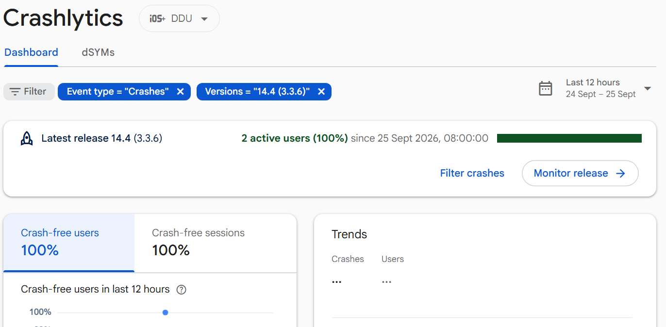

Firebase Crashlytics currently shows:
“App detected. Waiting for a crash to happen.”

There is an additional important observation regarding this issue:
When running the application in Debug mode, the application launches and runs successfully even with these linker settings.
However, when I create an IPA with the same linker configuration and install/run it through BrowserStack, the application crashes during startup.
The application crashes before I can reach the application UI, so I cannot reproduce the issue from within the application or capture the exception through normal application logging.
Because the crash occurs in the IPA/Release scenario, I currently do not have the actual exception or stack trace from the application.
When I remove the two linker configuration sections, the IPA launches successfully, but Firebase Crashlytics still remains in the state “App detected. Waiting for a crash to happen.”
This makes the issue particularly difficult to diagnose because Debug works, while the IPA/Release build crashes only when these linker settings are enabled.

The main issue is:
Without the linker settings: the application launches successfully, but Firebase Crashlytics does not receive crashes.
With the linker settings: Debug works, but the IPA/Release build crashes during startup when executed through BrowserStack, preventing me from obtaining the application exception.
