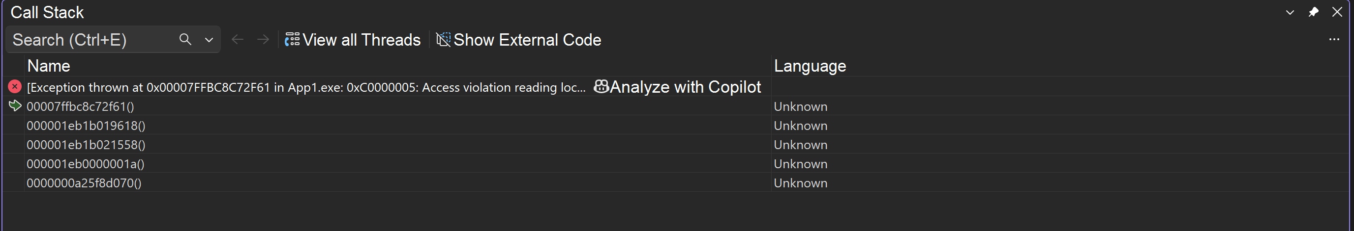

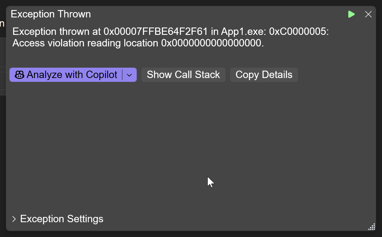

Thank you for providing the additional information, call stack, and clarification about the use of ToList().
The available evidence does not yet confirm that ObservableCollection itself is the root cause. The exception is a native access violation followed by a fail-fast in Microsoft.UI.Xaml, while the supplied call stack contains only unresolved native addresses.

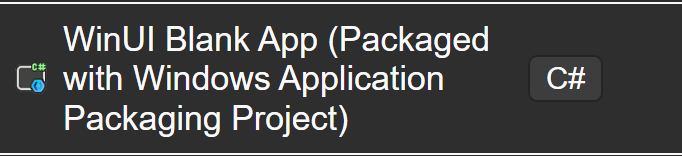

Please note that WindowsPackageType=None applies to the unpackaged App1 project you shared. I suggest testing this workaround in the same minimal project first. The Microsoft Store project's packaged configuration should be reviewed separately before applying this property to production.
