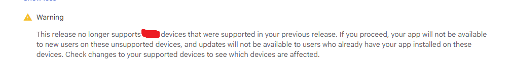

I am getting the below warning for my MAUI app from play store:
My Previous version was .net 8 with minSdkVersion 21 and targetSdkVersion 35. My current version is .net 10 with minSdkVersion 23 and targetSdkVersion 36.
I am getting below error when I tried to took the build with minSdkVersion as 21 on .net 10 project.
uses-sdk:minSdkVersion 21 cannot be smaller than version 23 declared in library androidx.lifecycle.runtime Suggestion: increase this project's minSdk version to at least 23
Problem is one of my Android dependencies requires minSdkVersion = 23. But my MAUI project is still building with minSdkVersion = 21.
I even tried below settings on manifest, but this also end with errors.

So is increasing Minimum Android Version only fix? In that case how we can manage the xxxx users?

    Yes. In this scenario, increasing the minimum Android version is the required fix.
    The build error is expected because a referenced Android library declares minSdkVersion 23, so the app cannot ship with minSdkVersion 21. The warning from Google Play is therefore a consequence of raising the app’s minimum supported Android version.

    About the affected users:
    • Users on devices below the new minimum version will not be able to install new updates.
    • Existing users on those unsupported devices can continue using the version already installed, but they will not receive future app updates.
    • The recommended action is to notify those users that newer app versions require a newer Android OS.
    This is consistent with platform guidance that when the minimum supported Android API level is raised, apps can no longer be installed or run on devices below that level, and users should be informed when updates are no longer available for older Android versions.
