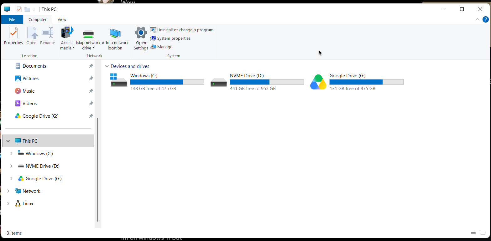

Environment: Windows 11 25H2, x64. Build 26200.9278 (KB5120998) was installed on Sep 8, 2026.
Symptom
Before the issue is fixed After the update, File Explorer opened with the legacy Windows 10 ribbon UI — no tabs, no modern command bar, no address/search band. It persisted after restarting explorer.exe, after a reboot, and in Safe Mode.
Diagnostics (elevated)
  • SFC /scannow: no integrity violations (live files match the component store).
  • DISM /ScanHealth: "The component store is repairable" — 766 CSI payload corruption entries, all in one component: amd64_userexperience-oobe_31bf3856ad364e35_10.0.26100.1591_none_54983d2d7a4908c4 (OOBE\resources.pri, WebExperienceHost.dll, WebHost.winmd, webapps\guidedsetup...\area-content.local.json). Manifest and metadata corruption: 0.
  • DISM /RestoreHealth: fails with 0x800f0915 "The repair content could not be found anywhere" (download stalls, then fails). The same failure is recorded in C:\Windows\Logs\DISM\dism.log on July 23, 2026, so the store has been unrepairable via Windows Update for weeks.
  • chkdsk /scan: clean, 0 bad sectors.
  • During KB5120998's online servicing phase (Sep 8 ~22:00), AppX registration failed repeatedly with 0x80070570 (ERROR_FILE_CORRUPT) for MicrosoftWindows.Client.OOBE, MicrosoftWindows.Client.CBS (344.0 -> 360.0), Microsoft.Windows.StartMenuExperienceHost, Microsoft.AAD.BrokerPlugin, plus "Failed to notify RDS of recovery trigger".

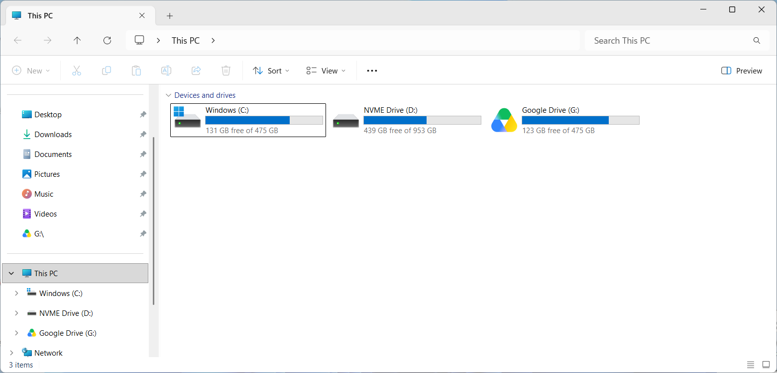

Workaround that fixed the shell
DISM /Online /Remove-Package /PackageName:Package_for_RollupFix~31bf3856ad364e35~amd64~~26100.9278.1.35 (exit 3010) followed by a reboot. The modern File Explorer immediately returned; the machine is now on build 26200.9168.
After the issue is fixed, the new WinUI is back. Questions
