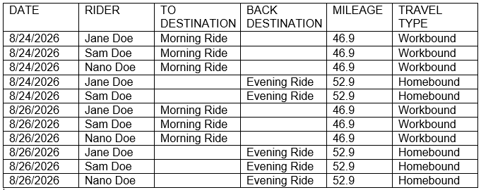

I need help with a formula to calculate the rate for part one-way and part round-trip travel.
For example; I have a group of 4 riders traveling from A to B and B to A, however, one of the riders decided not to take the return route. So there were 4 going and 3 coming back.
The formula I have calculates more rate for the one way rider than the rest of them. Why's that?
Help is appreciated.

George Hepworth 23,135 Reputation points Volunteer Moderator
2026-08-30T23:23:02.67+00:00
My previous suggestion applies. Add TravelType to the WHERE clause to segregate the calculations.
It's not clear whether you have a properly designed table with a Foreign Key for TravelType, or if you used a MultiValue field with those three values in it for TravelType. Either way, the parameter form will have to provide a control that allows you to indicate which one you want to calculate on.
Another option could be to add it to the query's SELECT and GROUP BY clauses. That would return all three.
EDIT: I made a mistake. I think this is the right syntax.
SELECT DailyCarPoolers.PU_Dt, DailyCarPoolers.TravelType, Count(*) AS DailyCarPoolerCount
FROM (SELECT DISTINCT PU_Dt, Carpooler, TravelType
FROM tblTravelRoute
WHERE PU_Dt BETWEEN Forms!frmParameter01a!txtStartDt AND Forms!frmParameter01a!txtEndDt  AND PU_Loc = 2)  AS DailyCarPoolers
GROUP BY DailyCarPoolers.PU_Dt, DailyCarPoolers.TravelType;

  1. Duane Hookom 27,035 Reputation points Volunteer Moderator
    2026-08-27T15:31:19.71+00:00
    It would help if you provided the formula(s) you are using. If they get complex, I would create a user-defined function that would perform the calculations, allow comments, and enable stepping through when testing.
