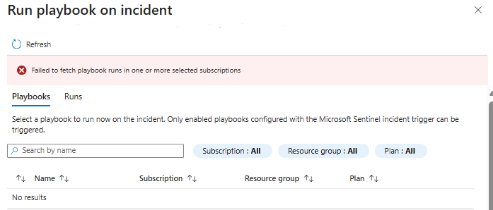

We are facing an issue while trying to manually execute a Microsoft Sentinel playbook from a Sentinel incident.
When we open an incident and select Actions → Run playbook, the playbook pane does not load any available playbooks. Instead, we receive the following error: Failed to fetch playbook runs in one or more selected subscriptions
The Playbooks tab displays “No results”, even though multiple enabled Microsoft Sentinel incident-triggered Logic App playbooks exist in the environment and were previously available.
At approximately the same time, the Azure portal also displays the following notification: Unexpected error: An error occurred while we were working on this page. Please try again later. If you continue to receive this error message, contact Microsoft support.

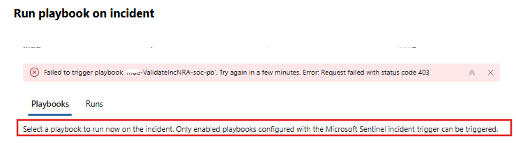

The same playbooks were visible in Microsoft Defender, but while executing in Defender it is showing the error: Select a playbook to run now on the incident. Only enabled playbooks configured with the Microsoft Sentinel incident trigger can be triggered.

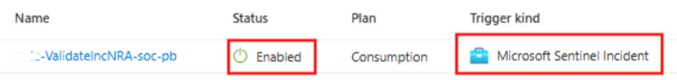

After checking the playbook details it does have sentinel incident trigger and enabled state

    1. In Microsoft Sentinel, go to Automation > Active playbooks.
      • Confirm the playbook appears there.
      • Confirm Status = Enabled.
      • Confirm Trigger kind = Microsoft Sentinel Incident.
      • Open the playbook from there to its Azure Logic Apps page and review run history and run results.
    2. Check the selected subscriptions.
      • The Active playbooks view is filtered by the current subscription view.
      • In the Azure portal, review Directory + subscription in the global header.
      • A playbook is usable by default only in the subscription where it belongs, unless Microsoft Sentinel was specifically granted permissions to the playbook resource group.
      • The error “Failed to fetch playbook runs in one or more selected subscriptions” is consistent with a subscription-scope problem.
    3. Verify Microsoft Sentinel permissions on the playbook resource group.
      • Microsoft Sentinel needs the Microsoft Sentinel Automation Contributor role on the resource group where the playbook resides.
      • To manually run playbooks, the operator also needs the Logic App Contributor role on the resource group that contains the playbooks.
      • If these permissions are missing, Microsoft Sentinel can fail to trigger the playbook and the health guidance explicitly lists “Microsoft Sentinel is missing permissions to run it” as a cause.
