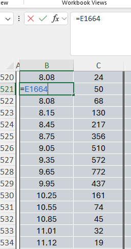

Hello I have one requirement-->
I have to fix the all the cell values of the large table by using $ sign (Absolute Reference).
This means that i want to select the table and press F4 (Absolute Reference) to fix cell values.
This means I need not want to click each cell value and press F4 every time.
Please suggest me.

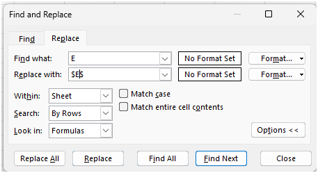

  1. riny 21,430 Reputation points Volunteer Moderator
    2026-08-26T13:09:52.9833333+00:00
    @Chaturvedi, Santosh
    If all of the cells in column B refer to a cell in column E, select the entire range with the relative references. Press Ctr-H (Find and Replace).
    Type E in in the "Find what:" box and $E$ in the "Replace with:" box. Then Replace All. Done.
    If not all references are to column E, repeat this process for each column that does get referenced in column B.
  2. Kristen Tran 860 Reputation points Independent Advisor
    2026-08-26T12:51:42.3766667+00:00
    Good day,
    Thank you for your question.
    Unfortunately, Excel does not provide a built-in method to apply absolute references ($) to all formulas in a selected table or range with a single F4 keystroke. The F4 shortcut only works on the cell reference currently being edited in the formula bar or in-cell edit mode, so it cannot automatically convert every formula within a selected range to absolute references at once.
    Based on the screenshot provided, if your intention is for all cells to reference the same fixed cell (for example, E1664), you can:
    1. Edit the first formula and change it to:
         =$E$1664
    2. Press Enter.
    3. Copy or fill the formula across the required range.
    All copied formulas will continue to reference the fixed cell $E$1664.
    Please note that this approach is suitable only when every formula should refer to the same cell. If the table contains different cell references that all need to be converted to absolute references, Excel currently does not offer a one-click feature to perform this action across an entire selected range.
