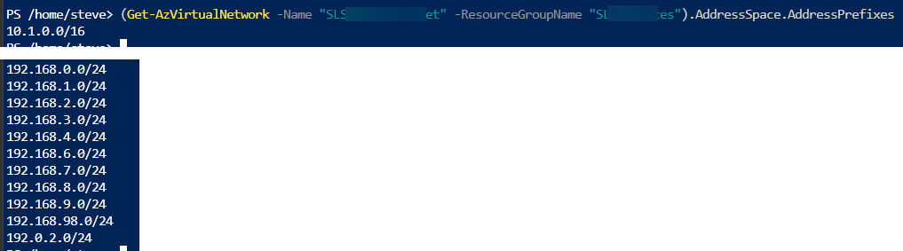

    The Meraki Health Check (MHC) actually uses google.com, 142.250.138.102 should resolve to google.com. BTW the MHC fails no matter what FDQN I use. My understanding is that the MHC intentionally uses the tunnel as a way to measure its "connection" status; if the MHC fails, the Meraki should automatically switch its uplink to the other WAN port.
    I know, from my open case with Meraki, the Health Check is going out, but no traffic is being returned (using port 80). This is what I'm trying to determine, what is blocking the "return".
    Below, you'll see the outputs for the addressing questions you asked. In terms of VMs in the Azure VNET, yes there are Windows VMs. I connect to them daily via RDP, using 10.1.0.0/16 addresses (from my subnet 192.168.0.0/24). From these VM's, we are able to use port 80/443, both incoming and outgoing.
    I'm appreciative of your efforts here, but I think this may be a futile attempt to solve something that is likely not possible with the Basic SKU. Once we have some development finished, we will likely upgrade the VNWG to the next up SKU, which I believe will be VpnGw1AZ. If you think we can solve this puzzle, one way or the other, using our current Basic SKU I'm willing to continue this. I'll let you make this call.
    Again, thank you!
    Steve Griffin
