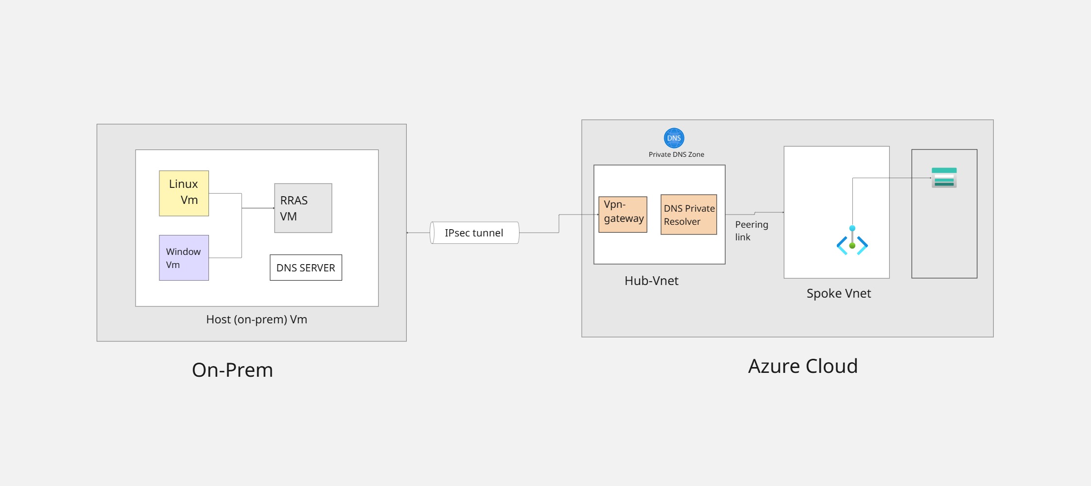

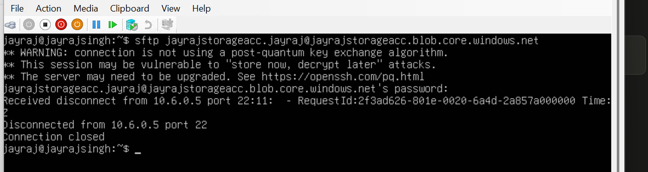

I have a window vm in that i have a another hyper v window-A vm and another linux vm whole connectivity is completely private when i try to connect sftp server i got Disconnected from port 22 error while i am able to reach the my storage privateEndpoint but when i tried to transfer the file from window-B vm which is another hyper v vm i was able to connect sftp server . this i a site-to-site setup . image (1)

    According to the screenshot, the Linux VM is successfully reaching the Azure Storage private endpoint at 10.6.0.5 on TCP/22. The failure occurs after the SSH/SFTP connection is established. The message “Received disconnect from 10.6.0.5 port 22” means the Storage SFTP service is actively closing the session, rather than TCP/22 simply being blocked.
    Because Window-B VM can successfully connect through the same site-to-site path, while the nested Linux VM cannot, I would focus on the difference in the source network path. The Linux VM is behind Hyper-V inside Window-A, so its traffic may be routed/NATed differently. In particular, verify whether Window-A is forwarding the Linux VM traffic correctly and what source IP the Azure side ultimately sees.
    From the Linux VM, run sftp -vvv ******@jayrajstorageacc.blob.core.windows.net and compare the output with a successful connection from Window-B. Also verify that the hostname resolves to 10.6.0.5 on both systems and test nc -vz jayrajstorageacc.blob.core.windows.net 22. If both resolve to 10.6.0.5 and TCP/22 succeeds, the next thing to investigate is SFTP authentication/session handling or the source IP/NAT behavior of the nested Hyper-V VM, not the site-to-site VPN itself.
