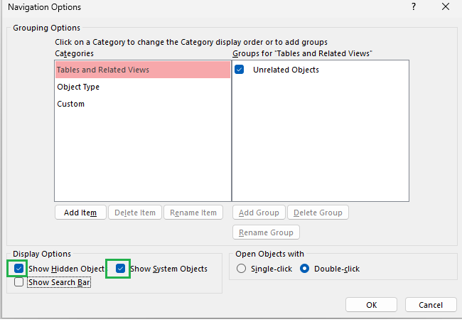

    • Press F11 to toggle the Navigation Pane open.
    • If objects appear dimmed or missing, right-click the top of the Navigation Pane, select Navigation Options, and check Show Hidden Objects and Show System Objects.

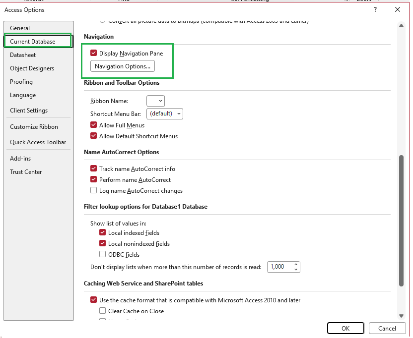

    • User's image
    • Go to File > Options > Current Database and make sure Display Navigation Pane is checked.
