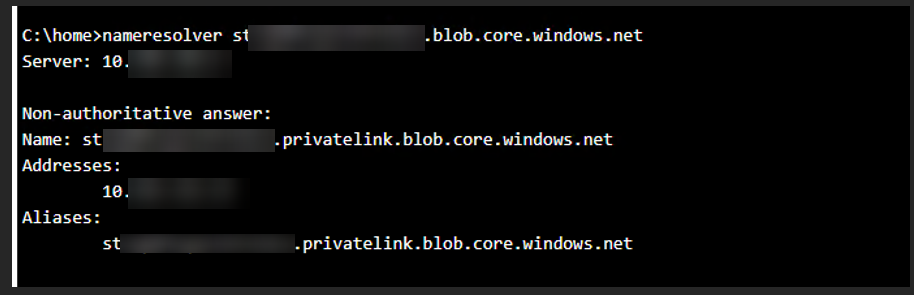

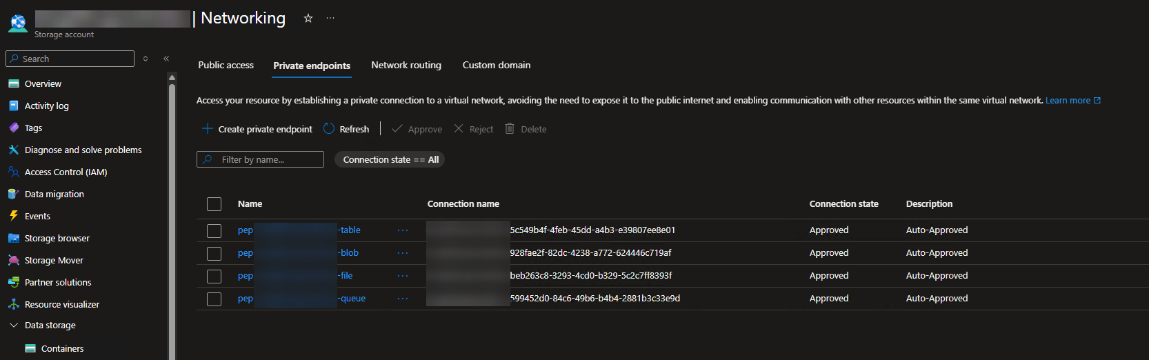

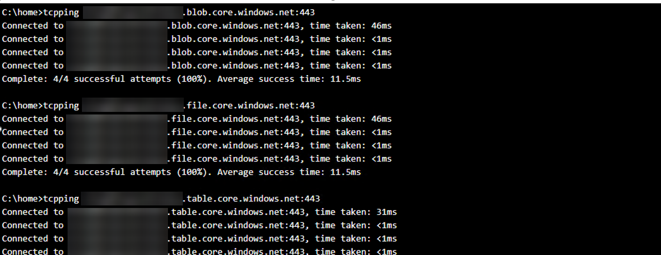

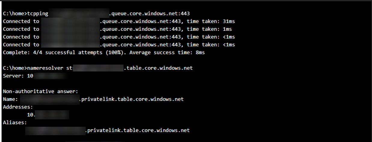

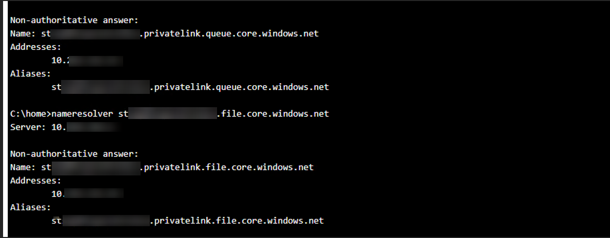

    Thank you for sharing the screenshots and configuration details.
    Based on the information provided so far, we understand that:
    • Private Endpoints are configured for the Blob, File, Queue, and Table services.
    DNS resolution is correctly resolving the storage endpoints to their private IP addresses.
    Network connectivity to the Storage Account is successful.
    Built-in connector workflows continue to function as expected.
