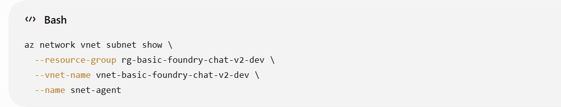

    As a final validation, you can confirm there are no remaining delegated resources by checking:
    If the output still shows the legionservicelink and no corresponding Microsoft.App/environments resource exists, that further indicates the Service Association Link has become orphaned.
