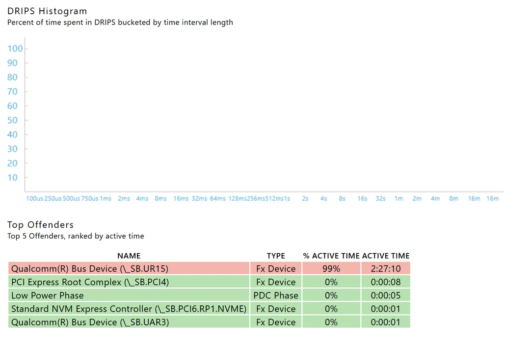

I ran sleep study (powercfg /sleepstudy) and I see it hasn't gone into Deepest Runtime Idle Platform State (DRIPS) at all during standby:
r/Surface - Surface Laptop 7 (Qualcomm Snapdragon) draining battery quickly in Modern Standby then hibernating

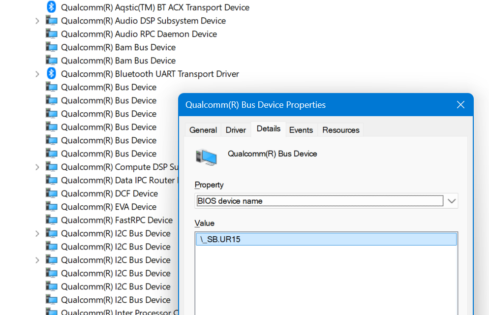

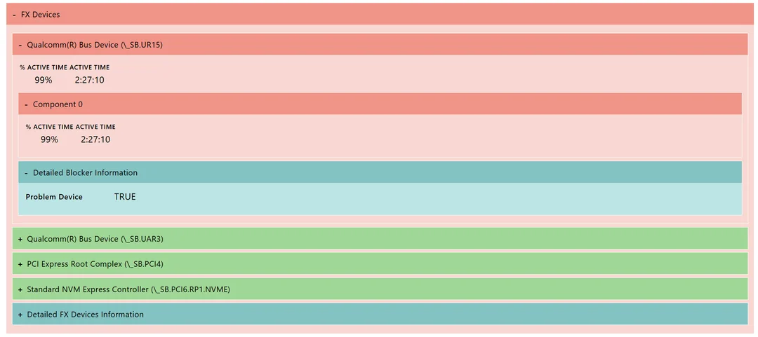

The top offender is Qualcomm Bus Device (_SB.UR15). Any idea what this could be? I'm really seeing nothing useful on the sleep report to see what could be causing this.
r/Surface - FX Devices section

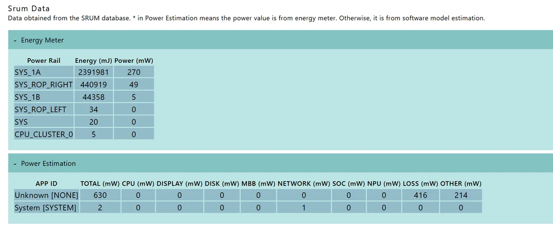

r/Surface - Srum Data section

    The problem device: _SB.UR15 is a UART bus, not a standalone peripheral — it's almost certainly carrying the Bluetooth radio's UART transport (or possibly GNSS/a sensor). The "Problem Device: TRUE" flag means Microsoft's own tooling has pinned it as what's blocking DRIPS. Airplane Mode/Disconnected Standby didn't help because those control network connectivity, not whether the UART driver is holding a power reference open.
    Suggestions:

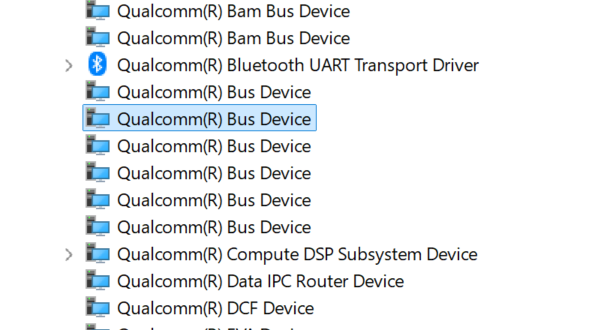

    Device Manager → View → Devices by connection → expand _SB.UR15 to confirm what's actually attached to it.
    Test: fully disable Bluetooth in Device Manager, then re-run powercfg /sleepstudy overnight. If UR15 clears up, Bluetooth's UART stack is confirmed as the cause.

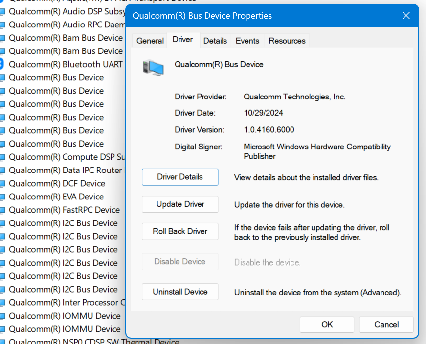

    Look for an updated Bluetooth UART Transport Driver or Qualcomm Bus Device package via Windows Update/Surface app.
