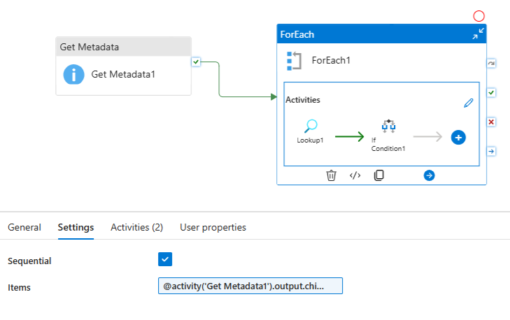

I asked Microsoft Co-pilot to give me some architecture of this logic, and it suggested using first "Get Metadata" to grab "child items", and then use "ForEach" to read each csv files, and then inside "ForEach", I have second "Get Metadata" using a parameter and @item().name, and then, it goes to "If Condition" and "Copy data".

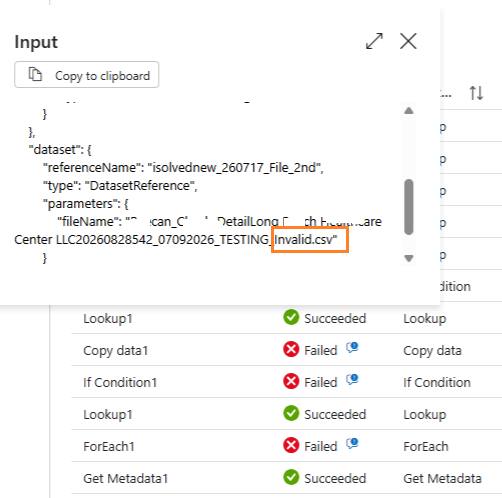

The error happens at "Copy data" (inside If Condition) that it still takes a csv file that has a bad data even though there is an expression that indicates to grab a csv file that has specific column names inside a csv file.

    A better pipeline structure is
    Get Metadata (childItems) > Filter by filename > ForEach > Lookup first row > If Condition > Copy Data

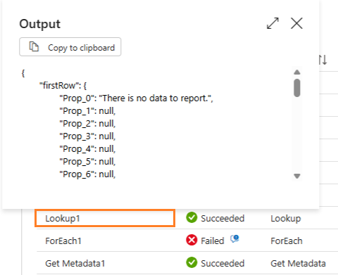

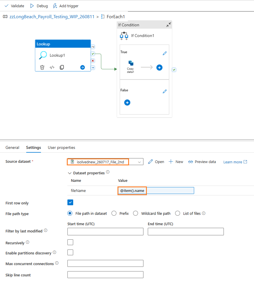

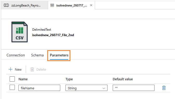

    Inside the loop, use a parameterized CSV dataset pointing to @item().name. Configure the Lookup activity with firstRowOnly = true, but set First row as header to false. This makes ADF return the physical first line as values such as Prop_0, Prop_1, etc., rather than interpreting "There is no data to report." as a column name. Lookup supports returning only the first row of a delimited-text file.
    The If Condition can then check either for the rejection message

    Run Copy Data only through the True branch. In the False branch, move the file to a rejected folder, log its filename, or simply skip it.
    Keep the Copy Activity’s actual source dataset configured with First row as header = true. Use a separate dataset for the Lookup validation with First row as header = false. Otherwise ADF may interpret the bad message as a header before your condition can validate it.
