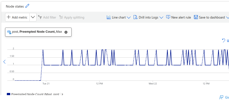

I run Azure Batch pools using spot nodes. Occasionally a node is preempted, which itself is not a problem. But I struggle to wrap my head around what happens to that node after it's preempted.
I observe is that the preempted node remains in the pool, and I have three questions about this:
  1. What happens to a Batch pool node after it gets preempted, and when? Do they ever leave the pool? Do they ever try to "recover" out of their Preempted state to Running again? I have not observed either of these; it seems that they just remain Preempted forever.
  2. Am I being billed for the preempted node as long as it remains part of the Batch pool?
  3. Autoscaling does not discount this preempted node when it checks if it has enough nodes or if it needs to scale-out. In my case, my Job had 1 active Task, the autoscaling rule therefore correctly set $TargetLowPriorityNodes -1But no new nodes were added because there was already 1 node in the pool; it didn't account for the fact that it was preempted so nothing could run on it. Assuming preempted nodes remain in that state indefinitely, is there a workaround to tell the scaling not to count them?
Here's max Preempted node count over the span of 2 days. On Tue 21, the count rose from 0 -> 1, when a very large pool had just 1 (or 2?) nodes preempted. But then that preempted node remains forever, until I manually deleted it. I can't explain the intermittent observations of count=2, but I wasn't actively watching the pool at those times.

  1. JeffreyCMI 116 Reputation points
    2026-07-29T14:00:46.8033333+00:00
    As an observer watching my Batch pools, I was able to confirm the following behaviors, all of which address my questions. I posted this as a new comment because my empirical observations have a lot of overlap with, but also slight differences from, the other comments posted here.
    What happens to a batch node after it gets preempted?
    In this case, my observations completely match VarunTha's response. Batch will periodically attempt to re-provision them (this is where I believe Alex Burlachenko is mistaken). The entire time -- even in Preempted state -- the node counts toward the pool size.
    The only thing that would remove a Preempted node from the pool is an autoscaling rule doing general scale-in.
    Am I being billed for the preempted node?
    The VM is gone, so you are not billed for compute. But I observe the hard disk and networking for the node remain while the node is preempted, so you do get billed for those. This is typically a tiny fraction of what the compute cost would have been: In my experience we pay about $1/day/preempted-node (USD).
    Autoscaling does not discount this preempted node when it checks if it has enough nodes.
    This statement is correct. And it's consistent with the observation that Batch is trying to re-provision the preempted node, so from the autoscaler's point of view, that preempted node might yet do some more work!
    One workaround to prevent starvation (when the preempted nodes never recover) may be to over-provision the pool. For example I use this:
    lookbackMinutes = 3;
    // Nodes preempted in the pool count toward pool size but run nothing,
    // so we add additional capacity to avoid task starvation.
    $preemptedNodes = max($PreemptedNodeCount.GetSample(TimeInterval_Minute * lookbackMinutes));
    $TargetLowPriorityNodes = $targetNodes + $preemptedNodes;
    I can't really explain the supply-and-demand of why this works. i.e. How can the autoscaler provision new nodes when existing nodes remained preempted? Oh well, no problem.
