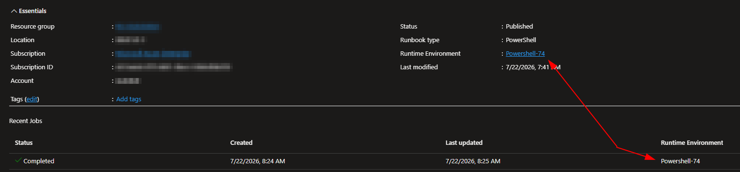

We've upgraded to the new runtime experience in Azure Automation, and I'm attempting to change the runtime environment for some of our PowerShell 5 jobs to 7.4 without any success.

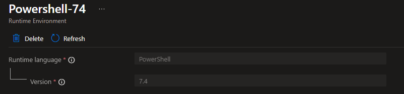

The runtime definition specifies PowerShell 7.4:User's image
The script indicates that it executed with the 7.4 runtime:

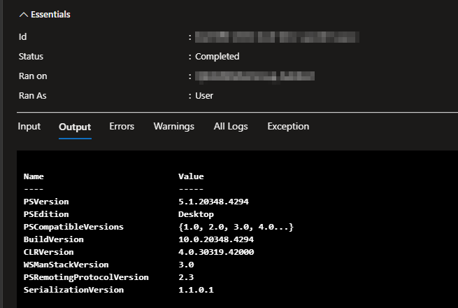

But the output of $PSVersionTable from the script indicates it's still executing with PowerShell 5.1.
These scripts are running on extension-based hybrid workers which have been configured with the appropriate environment variables for PowerShell 7.4 execution.
Scripts that originate in the 7+ runtime execute in 7.4 fine. This only seems to be an issue with scripts initiated in the 5.1 runtime and updated to run in a 7+ runtime. We can delete and recreate these scripts to execute in 7+, but I'm curious why the UI shows a runtime of 7.4 when execution is still happening in 5.1.

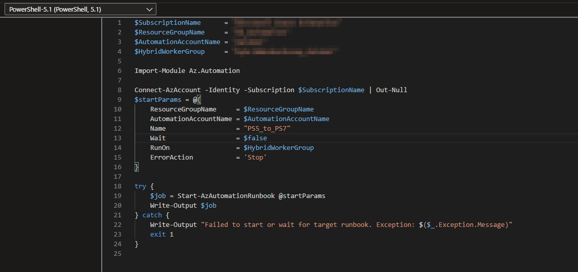

    I did some more testing, and it appears to have to do with the method I'm using to call the runbook. We have a handful of runbooks that are initiated by a 5.1 wrapper Runnbook because of this bug. Essentially, PS7 can't parse the incoming data and fails during pre-processing before it even has a chance to log anything meaningful to the console. Since PS5 is better at parsing the incoming data, we have a PS5 runbook accept the webhook, parse the data, and pass it into Start-AzAutomationRunbook with the parsed data in the parameter set.

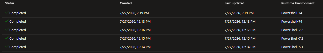

    I created a test runbook that just outputs $PSversionTable to the console and initialized it in the default 5.1 runtime. As expected, the output was 5.1 as expected. I changed it to 7.2, and then 7.4, and in both cases, it successfully executed with the 7.X version of PowerShell on my hybrid workers.

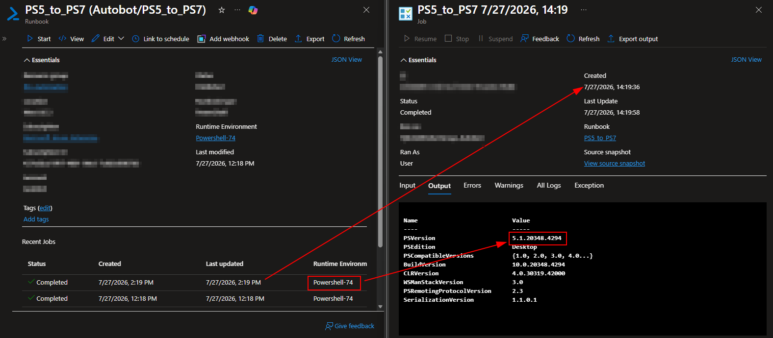

    This seemed to contradict what I claimed in my original post. To make a more accurate test, I tried initiating the runbook using Start-AzAutomationRunbook in a wrapper script similar to what we're using in production.
    This time, it ran as 5.1 despite the runtime environment being set to 7.4.User's image
    This only seems to be an issue if the runbook is initiated as PowerShell 5.1. A separate script initiated with the 7.2 runtime and run by the same wrapper script returns the expected 7.x result.
    For now, I've just been deleting scripts that were initiated in 5.1 and recreating them in 7.2 to make this work when called by the wrapper.

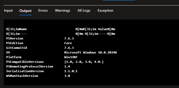

    Separately, I've noticed that if I initiate a runbook in a custom 7.4 or 7.6 environment, runbooks get stuck in the queue and eventually go into a suspended mode. I've ensured that my environment variables are set properly on the hybrid workers. If I intiate them using the defauly 7.2 runtime, they end up running with 7.6 anyway since that's the installed version of pwsh. I can also change the runtime to 7.4 or 7.6 after initializing them in 7.2 without any issues.

    When you change an existing PowerShell 5.1 runbook over to a PowerShell 7.4 Runtime Environment on extension-based Hybrid Workers.
    The portal correctly shows the runbook linked to your Powershell-74 environment (and the job also reports that environment), but the process that actually starts on the Hybrid Worker is still Windows PowerShell 5.1. Runbooks that were originally created under 5.1 can keep residual behavior even after the Runtime Environment is updated. Newly created 7.x runbooks work because they are created with the correct metadata from the start.
