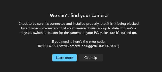

When loaded the app shows three progressive errors
CameraApp_001
CameraApp_002
CameraApp_003
Going to Settings > Apps & Features > Camera > Advanced Options and clicking 'Reset' has no effect.

Thank you for providing the screenshots and details.
Before we continue, I would like to mention that support for Windows 10 ended on October 14, 2025. While Windows 10 may continue to function, it no longer receives regular feature updates and support.
Looking at your description, the camera continues to work in Teams and through browser-based webcam testing, which indicates that Windows can still detect and access the camera. That may suggest the issue is isolated to the Camera app itself rather than a hardware problem with the camera or its driver.
