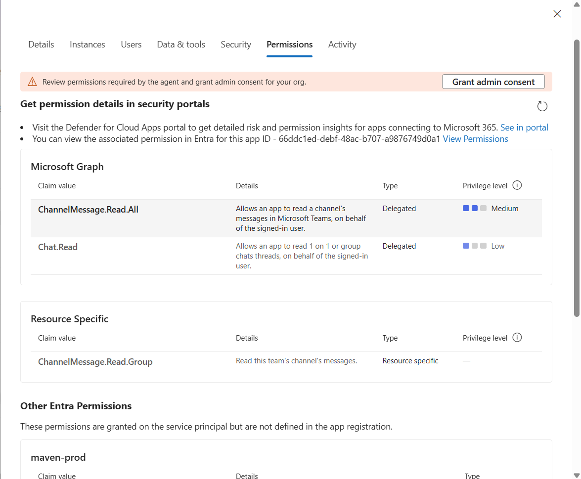

The Teams app manifest contains the following RSC permissions:
  "webApplicationInfo": {
    "id": "<YOUR_ENTRA_BLUEPRINT_ID>",
    "resource": "api://YOUR_ENTRA_AGENT_CLIENT_ID"
  "authorization": {
    "permissions": {
      "resourceSpecific": [
          "name": "ChannelMessage.Read.Group",
          "type": "Application"
Expected Behavior
We expect the AI Teammate to receive notification events for channel messages even when users do not explicitly @mention the agent, since:
The agent has its own identity in Entra ID.
The agent is already added as a member of the private Teams channel.
Required Resource-Specific Consent (RSC) permissions (ChannelMessage.Read.Group) have been configured.
Assistance Required
Could you please confirm:
Is ChannelMessage.Read.Group supported for AI Teammate custom identities to receive non-mention channel messages?
Are there any additional permissions, configurations, or tenant-level settings required to receive agents:* notifications for all channel messages?
Is the expected behavior that AI Teammates only receive messages when explicitly @mentioned?
Are there any additional SDK configuration steps required to enable background notifications for channel messages?
We would appreciate your guidance on the correct configuration required to receive non-mention channel messages for an AI Teammate.
