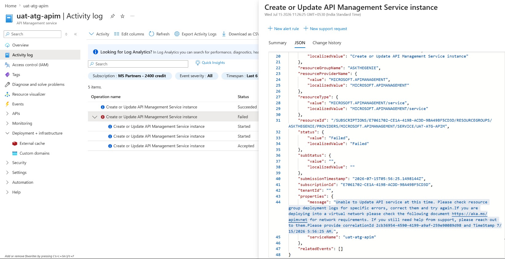

We are trying to update the custom domain in APIM and i have Lets Encrypt (certbot) certificate but when i am trying to add the certificate and click on save then after some time it fail to provide me the given hostname as custom domain (i also added cname and txt in my godaddy related to that subdomain) but i am getting this error so can you check
Unable to Update API service at this time. Please check resource group deployment logs for specific errors, correct them and try again.If you are deploying into a virtual network please check the following document https://aka.ms/apimvnet for network requirements. If you still need help from support, please reach out to them.Please provide correlationId 2cb36954-4590-4199-a9af-259e90089d98 and TimeStamp 7/15/2026 5:56:25 AM.

    Based on everything you have described it doesn't appear you are doing anything wrong and there is some sort of a service issue. There is another person experiencing same error as you. Unsure if that person is on consumption in East US 2 as well or different region.
    Just now I repeated my test with East US 2 (before I tested on East US) and was successful. It could be an issue with the particular deployment unit your APIM instance is on and not a region-wide problem.

    Thanks for the suggestion — I ran the exact test you described (self-signed cert via PowerShell New-SelfSignedCertificate, exported to .pfx, same CNAME already in place, uploaded as Custom type, saved, waited). It did not work the same way on my end — the update sometimes reports "Succeeded" in Activity Log, but the domain still returns a stale/wrong response (Azure's generic "Web Site not found" fallback page, or a cert mismatch), not a working connection like you got in Chrome.
    I also tried a third certificate delivery method since posting — Key Vault-backed certificate, with Managed Identity enabled on the APIM instance and granted Key Vault Secrets User (RBAC) + the automatic access-policy grant via the Portal's "Access Key Vault certificates" prompt. This attempt failed outright with the same generic error: "Unable to Update API service at this time."
    So across 3 different certificate sources — Let's Encrypt (Custom), self-signed (Custom), and Key Vault — none successfully bind the custom domain on my instance, while your self-signed test worked fine on yours. This makes me think it's something specific to my instance or region rather than a certificate content/format issue.
    My APIM region: East US 2
    Given self-signed worked for you but fails identically to my other attempts on my end, could this be:
    • A region-specific issue?
    • Some corrupted/stuck state specific to this APIM instance that a fresh instance wouldn't have?
    New correlation ID from the Key Vault failure: 33b9e8d4-157f-4543-ab6d-51abf3a0c513 (Previous ones already shared: d8789f39-1764-4a42-8d6b-8c7e8ad8727d, 3bf290f8-ec22-4870-8d66-0dfa58d3779f, 5080c867-1013-4dcd-9079-2a79cedc1660, 2cb36954-4590-4199-a9af-259e90089d98)
    At this point I suspect this needs a formal Azure Support ticket rather than continued troubleshooting here — would you agree, or is there something else worth trying first?
