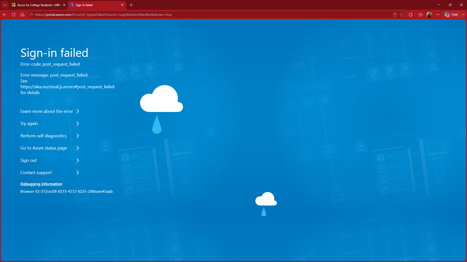

I cannot log in to my Azure student account. I have attached a screenshot of the sign-in failure.
Sign-in failed and 1 more page - Personal - Microsoft​ Edge 7_14_2026 4_17_07 PM.png.

    The error in your screenshot, post_request_failed, is a generic MSAL (Microsoft Authentication Library) error meaning the browser could not complete the network call to Microsoft's sign-in endpoint while trying to sign you in to the Azure Portal. Since you are signing directly into portal.azure.com rather than a custom-built app, the usual "register the redirectUri as SPA" advice does not apply to you, that guidance is for developers building their own applications. In your case the block is happening locally, in the browser or on the network path, before the request ever reaches Microsoft's servers. This is commonly caused by browser extensions, cached sign-in data, or a network or firewall blocking Microsoft's identity endpoints, which is common on college or campus Wi-Fi.

    Your screenshot shows Edge with several extensions and Copilot enabled in the toolbar. Ad blockers, privacy or script blockers, and VPN extensions are the most common cause of this exact error because they interfere with the POST request MSAL makes to the token endpoint. Go to edge://extensions, toggle all extensions off, and try signing in again. If it works, re-enable them one at a time to find the culprit.

    The sign-in failure page itself has a Perform self diagnostics option directly on it. Running that captures the specific failure details tied to your Browser ID (072ce20f-8373-4372-8225-2986aee43aab in your screenshot) and is the fastest way to get a precise root cause if the steps above do not resolve it.
    1. Contact support if it persists
    If none of the above resolves it, use the Contact support link on the same error page. Since this is an Azure for Students account, mention that you are on the student offer and include your Browser ID from the debugging information section so support can trace the exact failed request.
