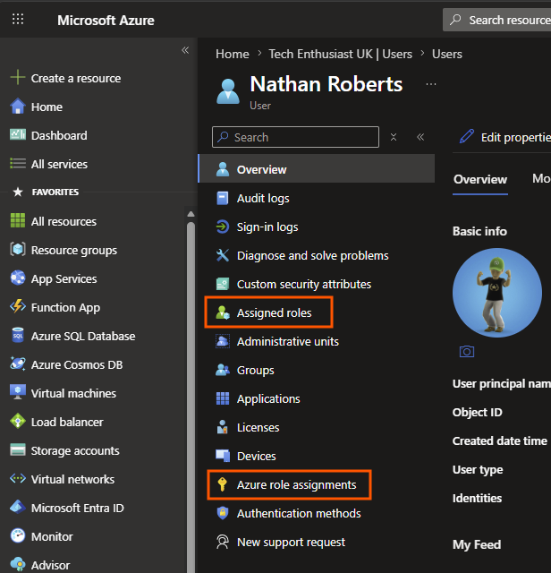

Sorry to read that you have been hacked in the past. Getting your account back, changing your password and adding two-step verification is a good first step. As the attacker managed to get onto Azure and create resources, which you were billed for, please can you sign into your account on the Microsoft Entra ID blade in the Azure portal here: https://portal.azure.com/#view/Microsoft_AAD_UsersAndTenants/UserManagementMenuBlade/~/AllUsers
Please check that the hacker hasn't added their own account to your tenant. If you do find any users who you don't recognise, please remove them so they are unable to access your tenant and resources.
Sometimes, what could happen is hackers will add their accounts to the tenant and then remove administrator privileges from your user account, while making them have administrator rights. This is why it would be worth checking your assigned roles and Azure role assignments, by clicking onto your user account and then assigned roles, found on the left-hand side menu

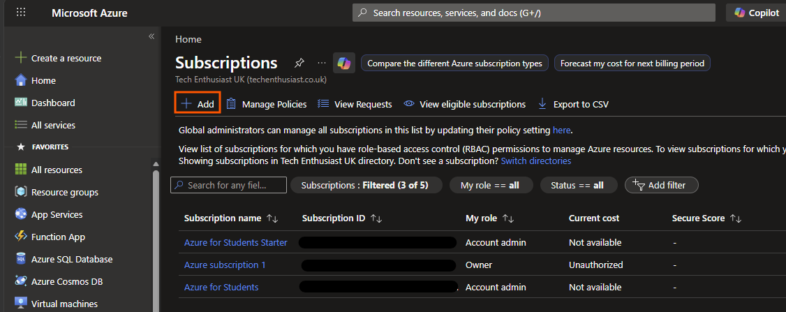

As you don't have access to the subscription, creating a support request is not going to be possible because support requests must be attached to a subscription.
Instead, please sign into your account on the subscription blade here: https://portal.azure.com/#view/Microsoft_Azure_Billing/SubscriptionsBladeV2
Once you have signed into your account, please click onto "Add" in the top-left under subscriptions.
This will open a side panel, where you can create a new subscription. Please enter a name for the subscription and select your account as the billing account. Then go through the other tabs, before finally going through to review and create.
Once you have created the subscription, please create a support request using the help & support blade here: https://portal.azure.com/#blade/Microsoft_Azure_Support/HelpAndSupportBlade
Please be aware, when creating a support request, it may take time for the support team to respond to you.
