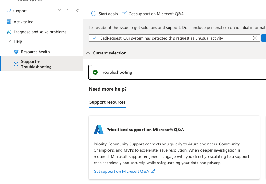

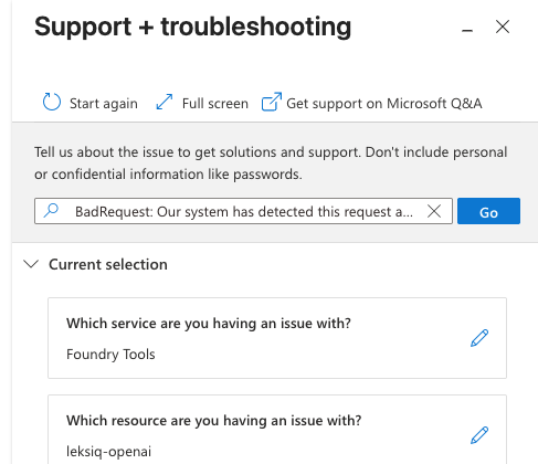

QUESTION
How do I get this account-level "unusual activity" restriction reviewed and removed?
What is the correct path to reach the Account Review / fraud-review team — for
example an email alias such as azcommunity@microsoft.com, or a specific portal flow?

    That points to an account/subscription-level restriction rather than anything specific to a model or resource. Unfortunately, there isn't a public process or email alias to request removal of this flag. It has to be reviewed internally by Microsoft. Since you already have a Developer support plan, I'd open a support request under Azure AI Foundry / Azure OpenAI and include the Trace ID +subscription ID+timestamp+affected regions+affected resources & confirmation that quota is available and billing is healthy.
    Ask specifically for the case to be routed to the team that handles account-level security/fraud reviews for Azure OpenAI. I wouldn't keep retrying deployments, since every request is being blocked by the same subscription-level check. The deployment API is just surfacing the restriction; it isn't the root cause.
