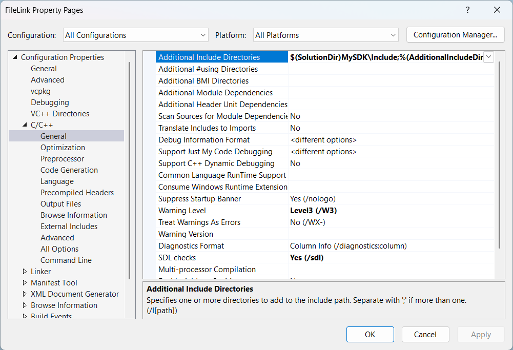

The solution did work for downloading and executing the vcpkg program by bypassing the strict, built in version . However, after the statement #include <GL/gl.h> and did the re-load in visual studio with C++, the loader still gave me the error "could not open the .obj file as specified". I suspect it is because of the additional Configuration Properties-->C/C++ --> General --> Additional Include Directories not pointing to the correct files for the #include and the Configuration Properties -->Linker-->General-->Additional Library Directories also not pointing to the proper locations. From your experience where should these additional directories be pointing? Sid Kraft

    I think the dirs u need are the ones vcpkg actually writes <vcpkg_root>\installed<triplet>\include and <vcpkg_root>\installed<triplet>\lib set those in VS.

      • Configuration Properties → C/C++ → General → Additional Include Directories
      • This should include the vcpkg include directory for the triplet you are using, for example:
        • …\vcpkg\installed\x64-windows\include The compiler then finds GL/gl.h via the normal include search order:
      • Local directory
      • Directories specified by /I (Additional Include Directories)
      • Directories from the INCLUDE environment variable

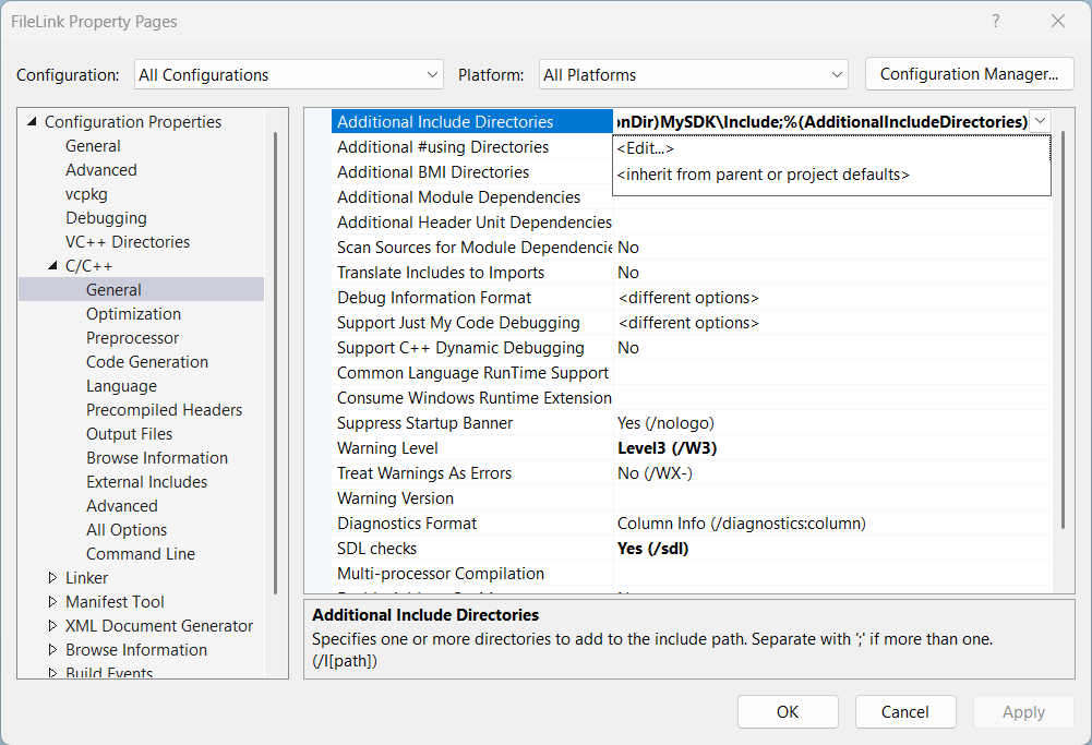

      Alternatively, use vcpkg integrate install so Visual Studio automatically adds the correct include directories. If user‑wide integration is enabled, make sure Additional Include Directories is set to inherit from parent; leaving it blank without inheritance overrides vcpkg’s augmented defaults and headers won’t be found.
