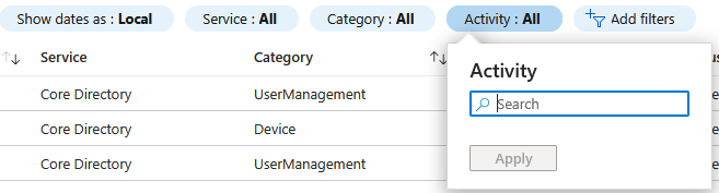

In the Azure or Entra Portals on the User/Audit Logs tab, the filters will open but are empty. This issue only recently started to occur. It affects all admins and is persistent across multiple browsers and in Incognito mode. Unfortunately, Microsoft wants to charge you to report issues to them when I try to submit a request to notify them of their broken service it says we need a support contract but this is obviously a service issue, not a configuration issue.
User's imageUser's image
This issue does not appear to affect one of our other tenants but it does affect all admins in this tenant.
