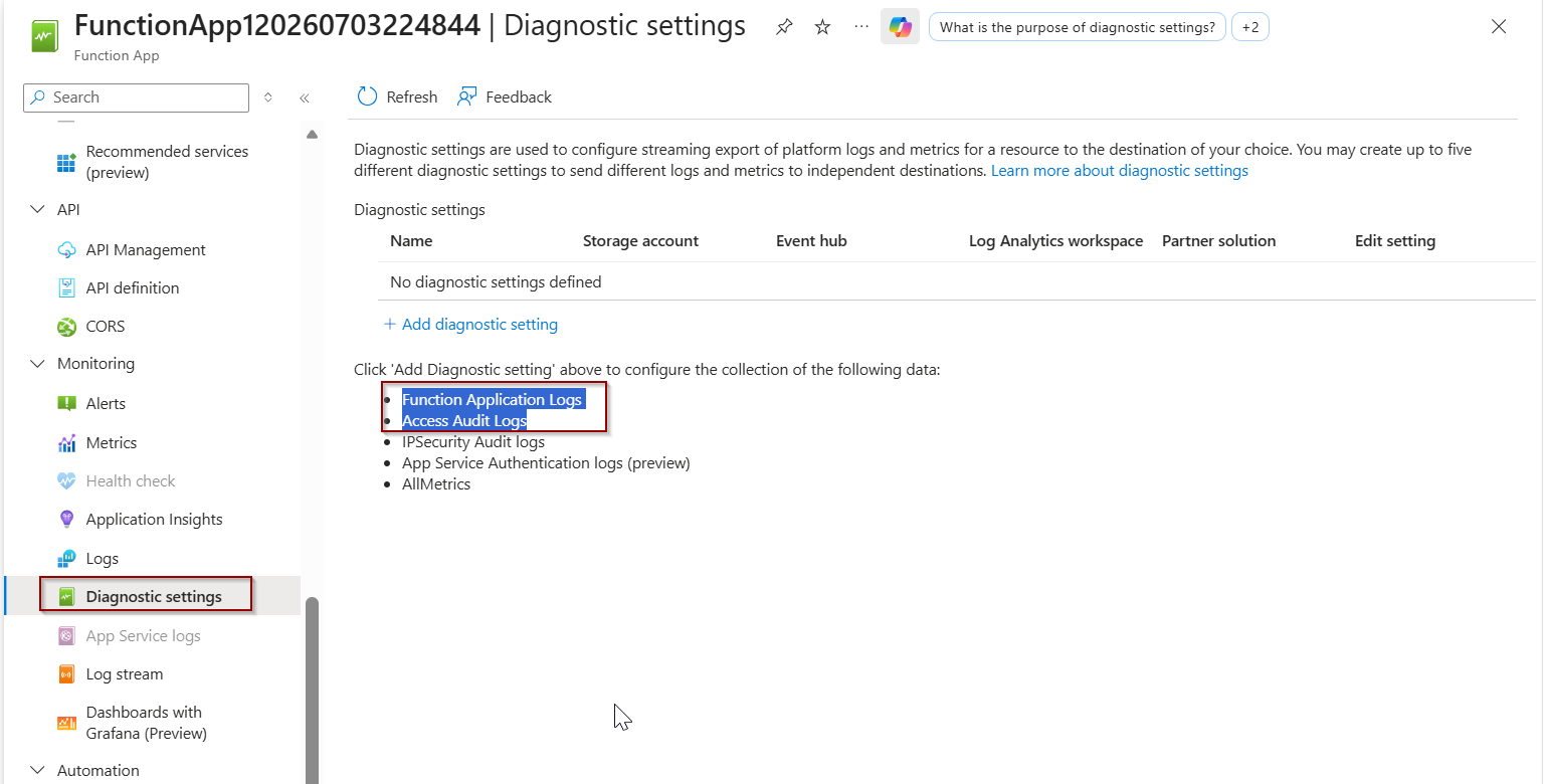

- Enable Diagnostic settings: Please check the below logs and share these logs for investigation
- Access Audit Logs
- Function Application Logs**
