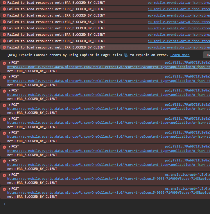

Hi, I have been working on my data factory for about a day now. I added a linked service and configured around 6 pipelines to feed into my PostgreSQL database. This was working successfully and I was getting ready to publish. I log in later today and everything is gone bar one of my Linked Services (I had two). Completely disappeared, no pipelines, resources or anything. I then go into the browser console and see loads of error messages.User's image
Example of one of the URLs
Failed to load resource: the server responded with a status of 401 () with a URL which outputs:
{"error":{"code":"AuthenticationFailed","message":"Authentication failed. The 'Authorization' header is missing."}}
OR
Failed to load resource: net::ERR_BLOCKED_BY_CLIENT
<Error>
<Message>The requested resource does not support http method 'GET'.</Message>
</Error>
I have tried the following:
InPrivate Browser
Second laptop
Relaunch multiple times

  3. Alex Burlachenko 23,575 Reputation points MVP Volunteer Moderator
    2026-06-30T10:05:13.8633333+00:00
    hi & thx for sharing urs issue here at Q&A portal,
    From the screenshot, the net::ERR_BLOCKED_BY_CLIENT errors are almost certainly a red herring. Those requests are to eu-mobile.events.data.microsoft.com (Microsoft telemetry), and they're commonly blocked by ad blockers, Brave Shields, uBlock Origin, Pi-hole, or enterprise filtering. They don't normally cause Azure Data Factory resources to disappear.
    The more important symptom is that all pipelines, datasets, and most linked services disappeared. That points to one of these You're connected to a different Data Factory (subscription/resource/branch).
    Git integration is enabled and you've switched branches or are viewing a branch without your changes. The changes were never published or committed and were lost after the browser session. A backend service issue or authorization problem prevented ADF Studio from loading the authoring metadata. I'd check
    Whether Git mode is enabled and which branch you're on.
    Whether Manage > Git configuration still points to the expected repository.
    Whether the missing pipelines exist under the Develop branch in your Git repo.
    Azure Activity Log to confirm nobody deleted the resources.
    Network tab (not Console) to identify any ADF REST calls returning 401/403/500, especially requests to management.azure.com or *.datafactory.azure.net.
    If the only failures are telemetry requests, they aren't the cause. If authoring API calls are returning 401, capture the failing request URL, Request ID, and timestamp those will help Microsoft determine whether this is an authentication or service-side issue.
    If the factory is in Git mode, it's also worth checking whether you're simply on the wrong branch before assuming the resources were lost.
    Based on ur description, I'd investigate Git/source control or a backend authoring issue before focusing on the ERR_BLOCKED_BY_CLIENT messages. Those are very common and, by themselves, shouldn't make pipelines disappear.
