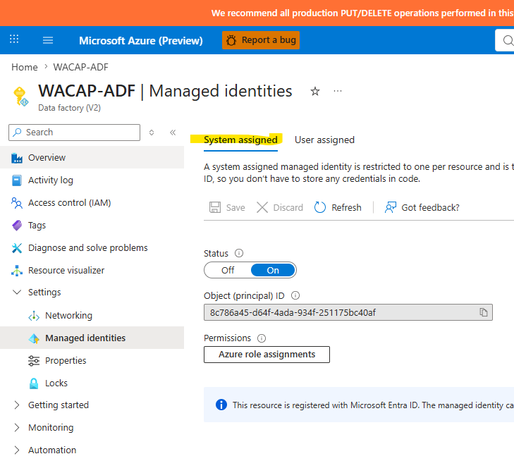

    I can see that you have already:
    • Verified the System-assigned Managed Identity is enabled.

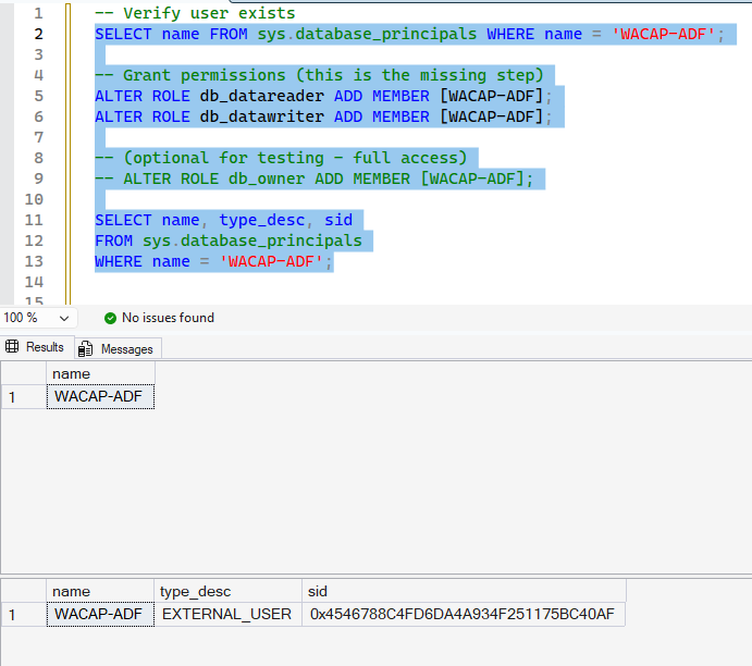

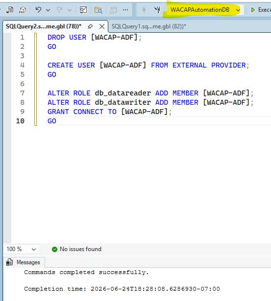

    • Recreated the database user using CREATE USER ... FROM EXTERNAL PROVIDER.
    • Granted the required database permissions.
    • Confirmed that the Managed Identity Object ID matches the database user.

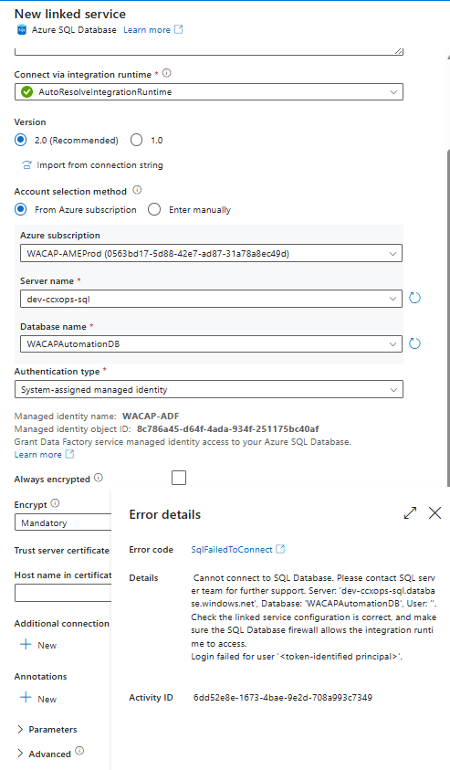

    Since the linked service is still failing with "Login failed for user '<token-identified principal>'", could you please verify the following:

    2. Verify that the database user has been created in WACAPAutomationDB (the target database) and not only in the master database.
    3. As a test, temporarily add the managed identity to the db_owner role and retry creating the linked service. If the connection succeeds, it would indicate that the issue is permission-related.

    I am using Managed Identity authentication and as per below ADF was added. However, still ADF Linked Service is failing.

    • The exact error message or screenshot received while creating the Linked Service.

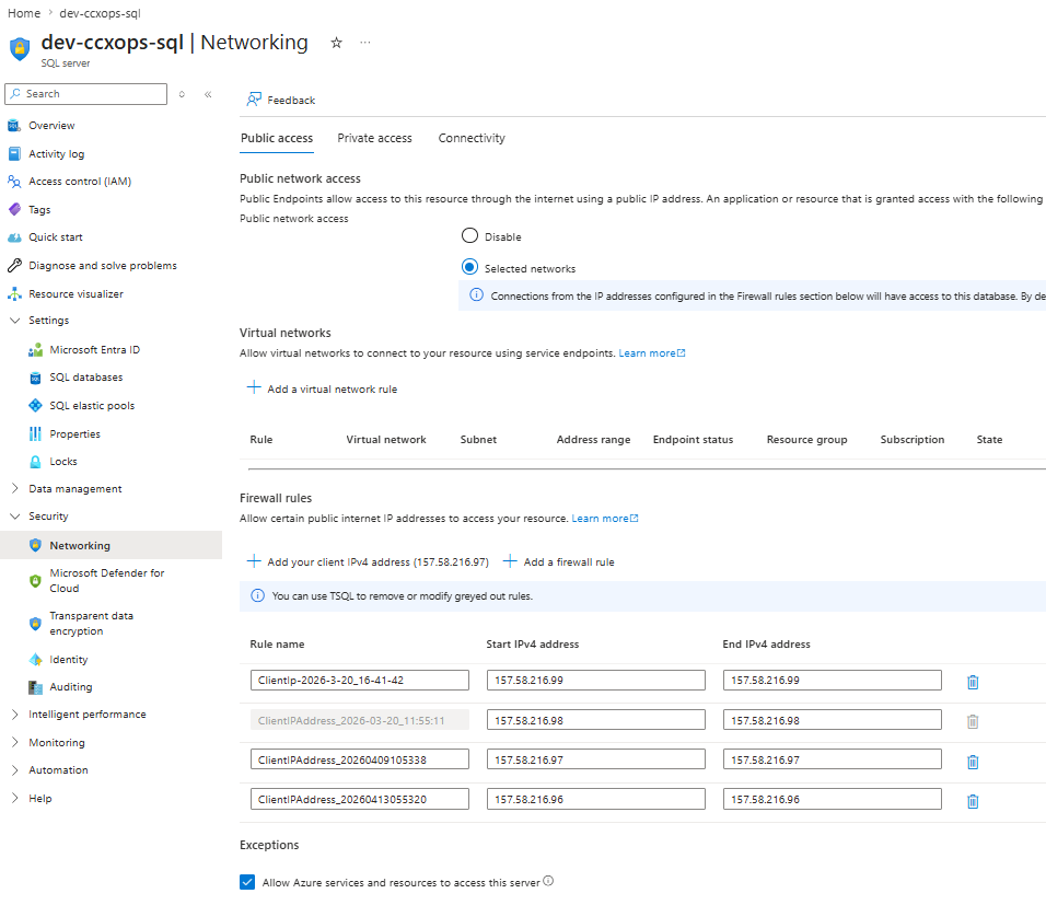

    • Whether the target Azure SQL Database is publicly accessible or configured with a private endpoint/firewall restrictions.

    • Any private endpoint, DNS, or network configuration is correctly configured.
