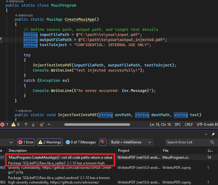

Can you help to the bug below? Which event is causing the issue?

Hello @Jonathan ,
Thanks for your question.
In your screenshot, the code is doing some PDF paperwork. However, when it is done with the PDF task, it never actually builds or returns the application. The method just ends.
The compiler is throwing the CS0161 error because the factory broke its contract—the operating system is waiting for an app, but the method didn't return one.
I recommend returning statement at the very end. You can refer to following code example:
public static class MauiProgram
    public static MauiApp CreateMauiApp()
        var builder = MauiApp.CreateBuilder();
        builder.UseMauiApp<App>();
        // Drop your PDF testing script here for now
        // string inputFilePath = @"C:\path\to\your\input.pdf";
        // ... rest of the try/catch logic ...
        return builder.Build();
    // Keep the PDF helper method outside the main builder
    // public static void InjectTextIntoPdf(...)

    The error is raised by the CreateMauiApp() method itself.
    CreateMauiApp() is declared with a return type (most likely MauiApp), but in the code shown there is no return statement. That’s why the compiler reports:
    MauiProgram.CreateMauiApp(): not all code paths return a value
    To fix it, ensure that every execution path in CreateMauiApp() ends with a return of the appropriate object, for example:
        // your setup code
        return builder.Build();   // or whatever object CreateMauiApp is supposed to return
